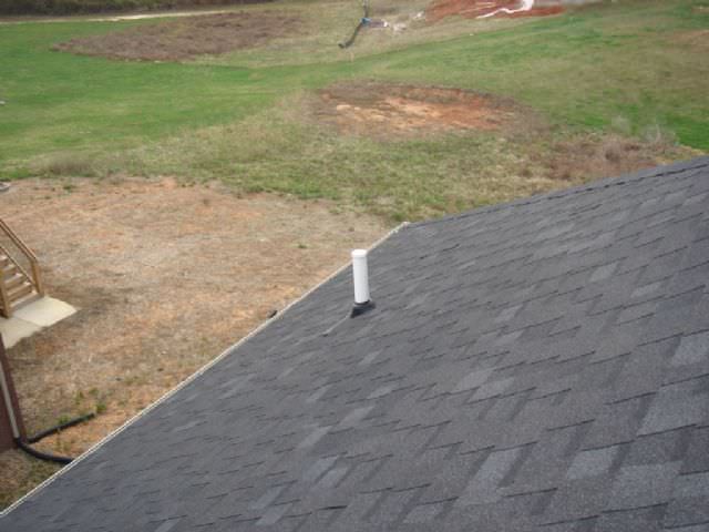

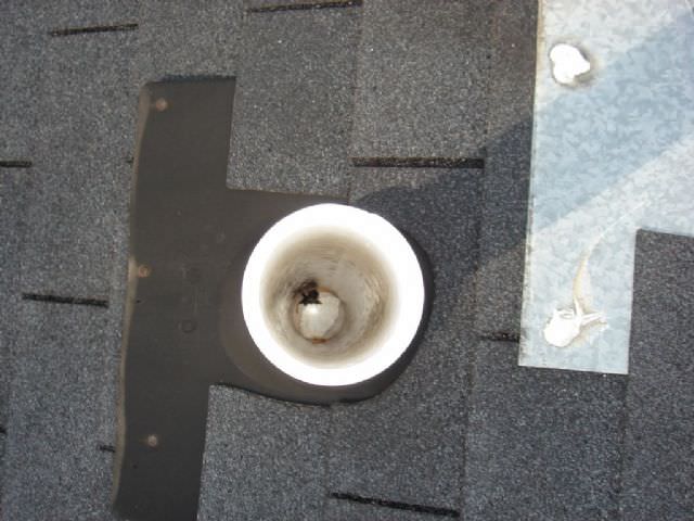

Bain Posted April 5, 2011 Report Share Posted April 5, 2011 . . . is the preferred weapon of choice. Click to Enlarge 57.66 KB Click to Enlarge 16.95 KB Quote Link to comment Share on other sites More sharing options...

kurt Posted April 5, 2011 Report Share Posted April 5, 2011 I'm not sure what I'm looking at.......are you sure the vent doesn't take a turn instead of it being blocked? Quote Link to comment Share on other sites More sharing options...
Bain Posted April 5, 2011 Author Report Share Posted April 5, 2011 I'm not sure what I'm looking at.......are you sure the vent doesn't take a turn instead of it being blocked? No, the pipe reduces to 2" from 3". Some yahoo whacked the test cap with a hammer rather than sawing it off. Quote Link to comment Share on other sites More sharing options...

Bain Posted April 5, 2011 Author Report Share Posted April 5, 2011 I'm thinking you city dwellers don't see PVC vents very often. Here, when a house is built, caps are glued to the tops of the vents--or sometimes bladders are inserted if there's access in the attic--and the drain system is pressure tested to make certain there are no leaks. Once the plumbing inspector okays the drains, the caps have to be removed. The quick and easy way to do that is to whack the cap with a hammer, like in my photos. But in my photos, the cap fell into the vent and is now blocking it. The CORRECT way to remove the caps is to saw them off with a hacksaw so the diameter remains what it should be, and also so the cap doesn't wind up in the vent. Quote Link to comment Share on other sites More sharing options...

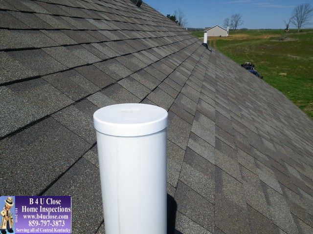

Bain Posted April 5, 2011 Author Report Share Posted April 5, 2011 And . . . sometimes the plumber neglects to remove the test caps. Like this: Click to Enlarge 51.69 KB Quote Link to comment Share on other sites More sharing options...
kurt Posted April 5, 2011 Report Share Posted April 5, 2011 got it now...... It's a colloquialism. We got lottsa those. Quote Link to comment Share on other sites More sharing options...

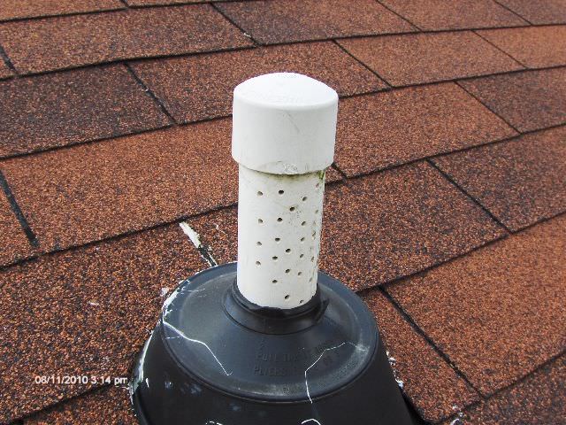

AHI in AR Posted April 5, 2011 Report Share Posted April 5, 2011 Y'all don't do it right. You should leave the cap on and then just drill a few dozen holes in the pipe! Click to Enlarge 101.79 KB Quote Link to comment Share on other sites More sharing options...
gtblum Posted April 5, 2011 Report Share Posted April 5, 2011 Y'all don't do it right. You should leave the cap on and then just drill a few dozen holes in the pipe! Click to Enlarge 101.79 KB Hmmm. If they had drilled into the side of the cap instead of the pipe, that would probably work just fine Quote Link to comment Share on other sites More sharing options...

plummen Posted April 7, 2011 Report Share Posted April 7, 2011 Y'all don't do it right. You should leave the cap on and then just drill a few dozen holes in the pipe! Click to Enlarge 101.79 KB Hmmm. If they had drilled into the side of the cap instead of the pipe, that would probably work just fine Now aint that special? Special ed plumbing that is! [:-crazy] Quote Link to comment Share on other sites More sharing options...
gtblum Posted April 7, 2011 Report Share Posted April 7, 2011 Y'all don't do it right. You should leave the cap on and then just drill a few dozen holes in the pipe! Click to Enlarge 101.79 KB Maybe I should have put one of the little smartass face thingys after that comment. Hmmm. If they had drilled into the side of the cap instead of the pipe, that would probably work just fine Now aint that special? Special ed plumbing that is! [:-crazy] Quote Link to comment Share on other sites More sharing options...
