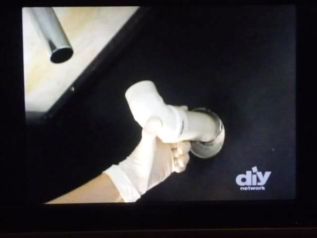

Richard Moore Posted April 7, 2011 Report Share Posted April 7, 2011 Follow our intrepid DIY network hostess as she shows us how to plumb a vessel sink drain, step by step. Click to Enlarge 24.7 KB Click to Enlarge 19.69 KB Click to Enlarge 19.84 KB Click to Enlarge 22.23 KB Click to Enlarge 20.83 KB Nailed that! [:-bigeyes On to the supply lines. Click to Enlarge 22.41 KB I wasn't even really watching this. Just happened to have the TV on the DIY channel when I quit a recorded show and caught this sequence. After doing a double take at the end result, my DVR allowed me to go back and take some screen shots with my camera. Please tell me that homeowners don't actually use this crap for educational purposes. Quote Link to comment Share on other sites More sharing options...

Richard Moore Posted April 7, 2011 Author Report Share Posted April 7, 2011 I sure hope our new friend is being sarcastic with his first post? Quote Link to comment Share on other sites More sharing options...
Inspectorjoe Posted April 7, 2011 Report Share Posted April 7, 2011 How long ago was this on? It wasn't April Fool's Day, was it? Quote Link to comment Share on other sites More sharing options...

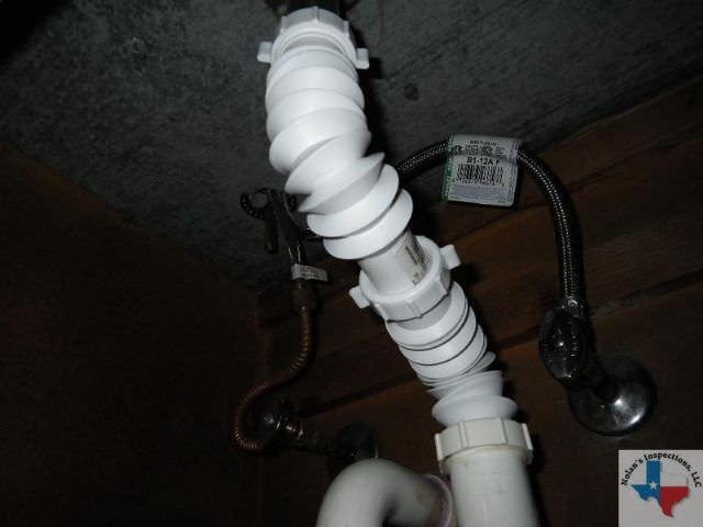

Nolan Kienitz Posted April 7, 2011 Report Share Posted April 7, 2011 And you can add the below. The glass bowl sink on top was very nice ... but was "slow to drain". Go figure! Click to Enlarge 33.33 KB Quote Link to comment Share on other sites More sharing options...
msteger Posted April 8, 2011 Report Share Posted April 8, 2011 I see those damn corrugated flexible drain pipes all of the time. I can't believe anyone installing one of those thinks it's a good idea. Quote Link to comment Share on other sites More sharing options...
