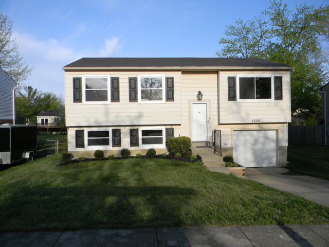

Ben H Posted April 13, 2011 Author Report Share Posted April 13, 2011 Not really visible at all. Click to Enlarge 54.14 KB Quote Link to comment Share on other sites More sharing options...

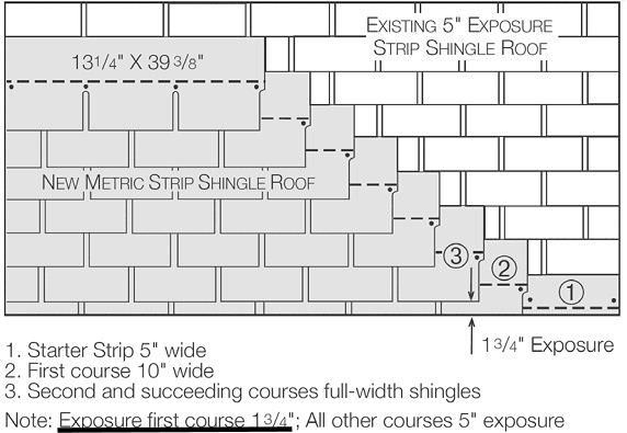

Mike Lamb Posted April 13, 2011 Report Share Posted April 13, 2011 It looks like they used what's called "nesting" to place the new shingles. Saves a lot of time and they sit better but it looks like they didn't do it till the 2nd course which is wierd. http://www.asphaltroofing.org/pdf/tb_203.pdf Click to Enlarge 45.76 KB Quote Link to comment Share on other sites More sharing options...
Ben H Posted April 14, 2011 Author Report Share Posted April 14, 2011 Mike, isn't that a practice used on a roof that has two layers? This house only had one. They stripped the old roof down to the beat up 1/2 ply, slapped some new osb on it, and then shingled it. Quote Link to comment Share on other sites More sharing options...
Mike Lamb Posted April 14, 2011 Report Share Posted April 14, 2011 Mike, isn't that a practice used on a roof that has two layers? . Yes. I didn't read your post carefully. Sorry. It looked like nesting. Quote Link to comment Share on other sites More sharing options...
