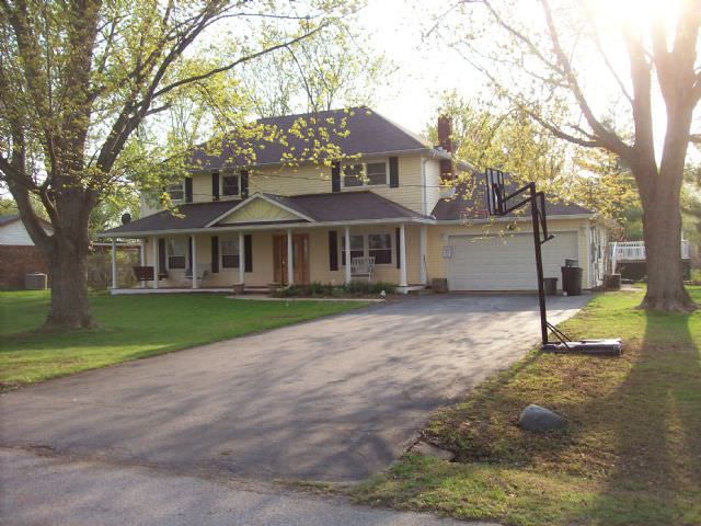

ericwlewis Posted April 19, 2011 Report Share Posted April 19, 2011 It's a dumb idea: It's costly; it's inconvenient; and in the end it always looks like crap. Click to Enlarge 75.67 KB Click to Enlarge 63.96 KB I don't think these two look so bad. If I say so myself. In both cases the homeowners loved the neighborhood and only spent about $75,000. Quote Link to comment Share on other sites More sharing options...
