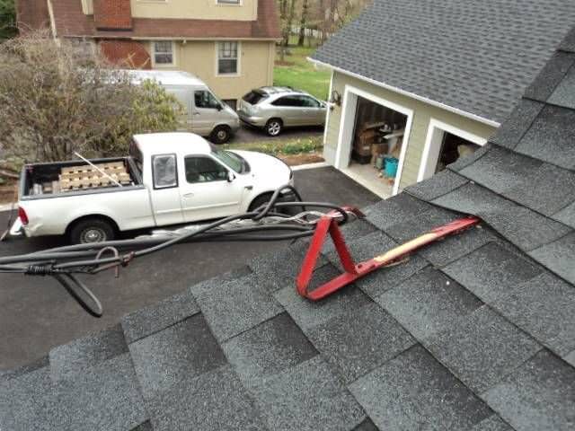

Neal Lewis Posted April 17, 2011 Report Share Posted April 17, 2011 New construction. All permits supposedly closed out. Click to Enlarge 67.65 KB Quote Link to comment Share on other sites More sharing options...
Ben H Posted April 17, 2011 Report Share Posted April 17, 2011 That is great. I'd email, or snailmail that pic to the city. Quote Link to comment Share on other sites More sharing options...
ghentjr Posted April 17, 2011 Report Share Posted April 17, 2011 Better yet, to the local TV station. Quote Link to comment Share on other sites More sharing options...
David Meiland Posted April 18, 2011 Report Share Posted April 18, 2011 Wow. Was that put there by the electrician? The roofers wouldn't have used it on that pitch, maybe on the upper section... Quote Link to comment Share on other sites More sharing options...
Tom Raymond Posted April 18, 2011 Report Share Posted April 18, 2011 Neal, when I swipe this pic would you prefer the credit be given to you or your biz? Quote Link to comment Share on other sites More sharing options...
gtblum Posted April 18, 2011 Report Share Posted April 18, 2011 Wow. Was that put there by the electrician? The roofers wouldn't have used it on that pitch, maybe on the upper section... Very good point.[:-thumbu] Quote Link to comment Share on other sites More sharing options...
Scottpat Posted April 18, 2011 Report Share Posted April 18, 2011 I usually find 2x4's nailed to the roof and half rotted, most of the time around the chimney! Quote Link to comment Share on other sites More sharing options...
hausdok Posted April 18, 2011 Report Share Posted April 18, 2011 I usually find 2x4's nailed to the roof and half rotted, most of the time around the chimney! Yeah, when I saw that I actually thought to myself that it was better than about a third of the attachments I see where the power company has an insulated lagged to a piece of two-by tacked onto the roof. ONE TEAM - ONE FIGHT!!! Mike Quote Link to comment Share on other sites More sharing options...
