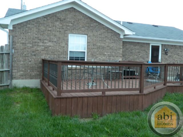

Ben H Posted April 18, 2011 Report Share Posted April 18, 2011 My house has zero afternoon shade in the backyard. I built a pretty nice deck a few years ago, and the wife would like to be able to use it in the afternoons after work. But summers here are flat out unbearable in the sun. I do have one of the yard umbrellas, but I'm trying to think "bigger". I had also considered a awning, but can't really afford a nice one, and refuse to buy a cheap one. So I'm just trying to get some suggestions for creative (not breaking the bank) ideas on how to get this done. Click to Enlarge 55.35 KB Quote Link to comment Share on other sites More sharing options...
Mark P Posted April 18, 2011 Report Share Posted April 18, 2011 How about building a pergulia over a portion of the deck. I've seen some nice one that provide good shade. Quote Link to comment Share on other sites More sharing options...
Ben H Posted April 18, 2011 Author Report Share Posted April 18, 2011 I have considered it, but one of my hold backs is attaching it to the house. I'd rather not add the extra weight to the brick veneer. Quote Link to comment Share on other sites More sharing options...
Charles Posted April 18, 2011 Report Share Posted April 18, 2011 Ben Try a offset umbrella. I have a similar deck here if North Florida and the late afternoons on the deck were unbearable. I also planted some rapidly growing Drake Elms. They look very nice and have a large crown that provides shade. Charles Quote Link to comment Share on other sites More sharing options...
Ben H Posted April 18, 2011 Author Report Share Posted April 18, 2011 Charles, while at Sams club the other day I saw that massive offset umbrella they have. Unfortunately, the reviews I read online are less than enthusiastic. It appears they plastic just get s brittle after a year in the sun. However Ikea does have one for only 80 bucks. A man could almost justify one a year at that price. Really, I was hoping for something more storm proof Quote Link to comment Share on other sites More sharing options...

kurt Posted April 18, 2011 Report Share Posted April 18, 2011 I researched this for a moneyed client a few years back. There are not any options for cheap affordable awnings or shades. The stuff I found that was reasonably priced was all cheap vinyl crap without adequate UV inhibitors; they all go to shards in a year or two. Weather and UV resistant fabrics are freaky expensive. Quote Link to comment Share on other sites More sharing options...
allseason Posted April 18, 2011 Report Share Posted April 18, 2011 Why not build a free standing pergola, simple design with poles and rafters. Plant with deciduous vines, this provides shade in winter and sun in cooler months. Quote Link to comment Share on other sites More sharing options...
Tom Raymond Posted April 18, 2011 Report Share Posted April 18, 2011 Although nowhere near as cool as the Ramon's idea, what you need is a Sunsetter awning. There are specific instructions for attaching one to the brick veneer, but I'd go with a free standing unit. The motorized version is less than $2K. http://www.sunsetter.com/oasis_awning.htm Quote Link to comment Share on other sites More sharing options...
Ben H Posted April 18, 2011 Author Report Share Posted April 18, 2011 Speaking of a pergola. If you "did" attach the ledger to the brick, with say 2x8 material (roughly 10 ft span from the house), think I'll crack the veneer over time? I suppose I could try to get the wall studs, but that won't be easy as a rim joint on a deck. Quote Link to comment Share on other sites More sharing options...
Tom Raymond Posted April 18, 2011 Report Share Posted April 18, 2011 Put up posts and make it free standing. Quote Link to comment Share on other sites More sharing options...
kurt Posted April 18, 2011 Report Share Posted April 18, 2011 Why not build a free standing pergola, simple design with poles and rafters. Plant with deciduous vines, this provides shade in winter and sun in cooler months. That's the best idea. Awnings start out looking like Grandma and Grandpa's house, then go downhill. Quote Link to comment Share on other sites More sharing options...
Ben H Posted April 18, 2011 Author Report Share Posted April 18, 2011 Thats the problem. I've been staring at it for days and can't come up with a design I like for post. I don't want to build it and it look like an afterthought (which it is)... Quote Link to comment Share on other sites More sharing options...

Ben H Posted April 18, 2011 Author Report Share Posted April 18, 2011 I think I'm going to go the pergola route. The wife seems happy with that idea as well. I'll work out the details and run it by you boys this week. Thanks all. Quote Link to comment Share on other sites More sharing options...
