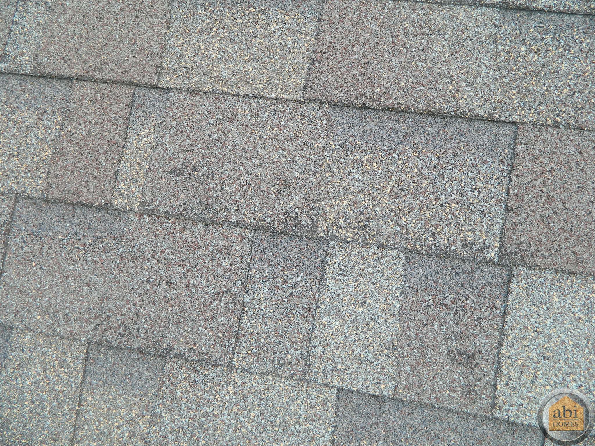

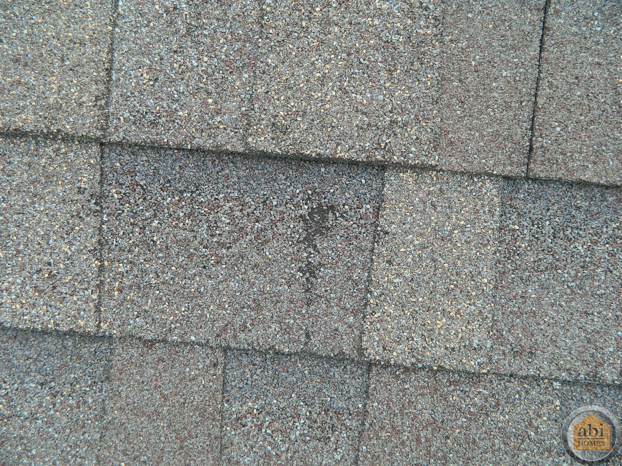

Ben H Posted April 20, 2011 Report Share Posted April 20, 2011 The house was 11 months old. I can only image the roof a tad bit older. There were a few sections, not the whole roof that had pretty bad granular loss. At least I would consider it bad for being basically a new roof. I'm looking for some good wording for the report. Download Attachment: DSCN4859.jpg 1832.2 KB Download Attachment: DSCN4860.jpg 1695.32 KB Download Attachment: DSCN4863.jpg 1780.98 KB Quote Link to comment Share on other sites More sharing options...
John Kogel Posted April 20, 2011 Report Share Posted April 20, 2011 I can't say for sure, but I've seen similar damage caused by foot traffic. Hot day, guys scrambling to get the siding up. If that's the case, the damage pattern will follow the obvious path from the ladder, and go below and around the sides of the dormers. I would then just report it as damage from foot traffic. Quote Link to comment Share on other sites More sharing options...
Ben H Posted April 20, 2011 Author Report Share Posted April 20, 2011 I was thinking possible foot traffic, but most foot damage I've seen has a "smeared" look to the spot. It was near a valley, which would make sense when walking up a semi-steep pitch. Quote Link to comment Share on other sites More sharing options...
caryseidner Posted April 20, 2011 Report Share Posted April 20, 2011 Looks like foot traffic to me. Quote Link to comment Share on other sites More sharing options...
hausdok Posted April 20, 2011 Report Share Posted April 20, 2011 They were sliding the heavy bundles over the surface as they went up. OT - OF!!! Mike Quote Link to comment Share on other sites More sharing options...
mgbinspect Posted April 20, 2011 Report Share Posted April 20, 2011 I see that a fair amount on front porch roofs here, which tend to be very poorly ventilated, which accelerates aggregate loss. We see our share of 100 degree days here. I suppose a valley made from the junction of an architectural front facade gable that isn't open to the main attic could cause the very same overheating. I'm not saying that's the culprit, but that is certainly the number one cause of aggregate loss around here - other than foot traffic. And, as has already been brought up, foot traffic is usually pretty obvious. So, if it's on the sunniest slope in a ventilation challenged section of the attic, that would be my bet. Quote Link to comment Share on other sites More sharing options...
ericwlewis Posted April 20, 2011 Report Share Posted April 20, 2011 I'd tend to agree with the sliding bundles. That will do a lot of damage. Quote Link to comment Share on other sites More sharing options...
Rocon Posted April 21, 2011 Report Share Posted April 21, 2011 The first two photos show light to moderate de-granulation. When you see that look at the gutters and if you see a lot of granules in the gutter you will know. The skrim is just visible at the bottom edges but not bad, and I donââ¬â¢t see any delamination. The third photo shows what happens when a shingle is bent/folded. The shingle above it also looks like it has been folded but the lines are offset by an inch or so. If I was going to guess it looks like some shingles have been removed and reset. If not it is just a fold. Overall the roof probably has 8-10 years of service life left. Quote Link to comment Share on other sites More sharing options...
