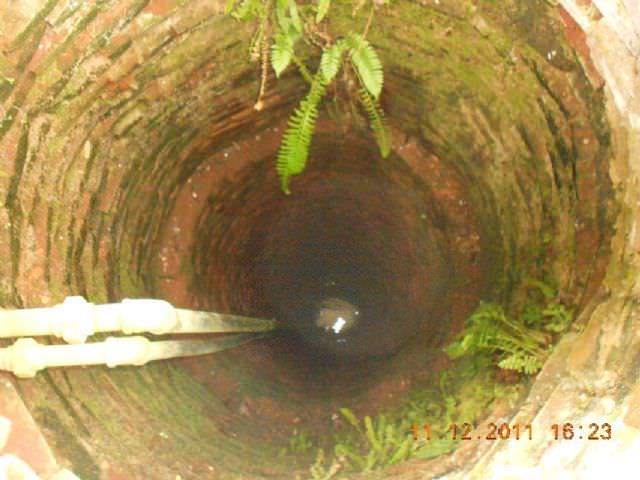

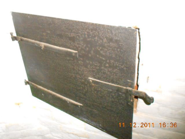

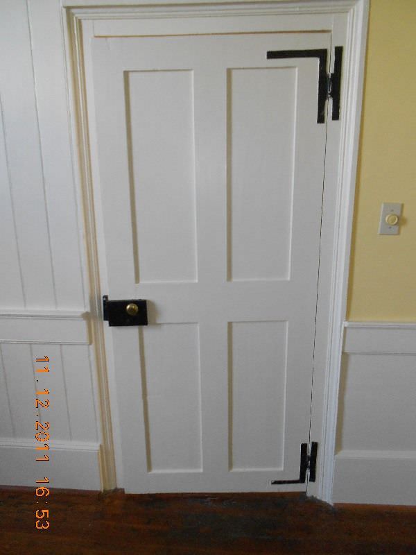

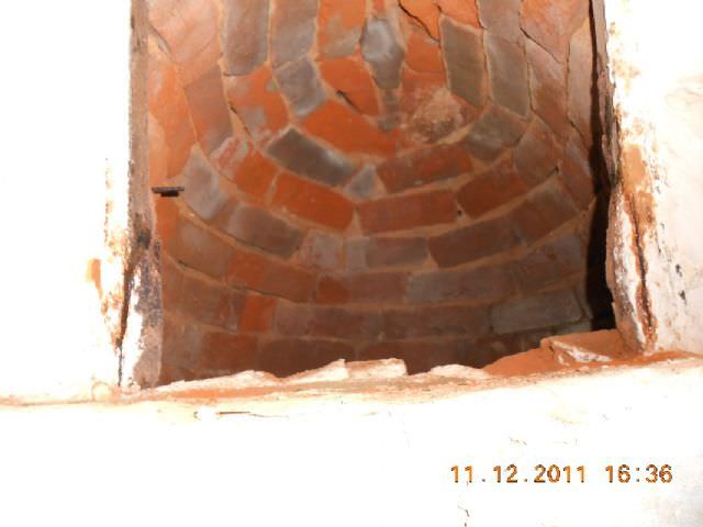

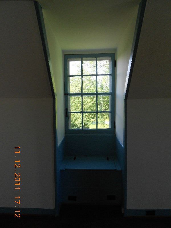

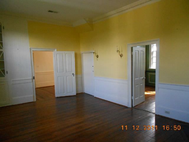

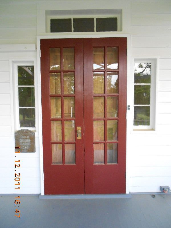

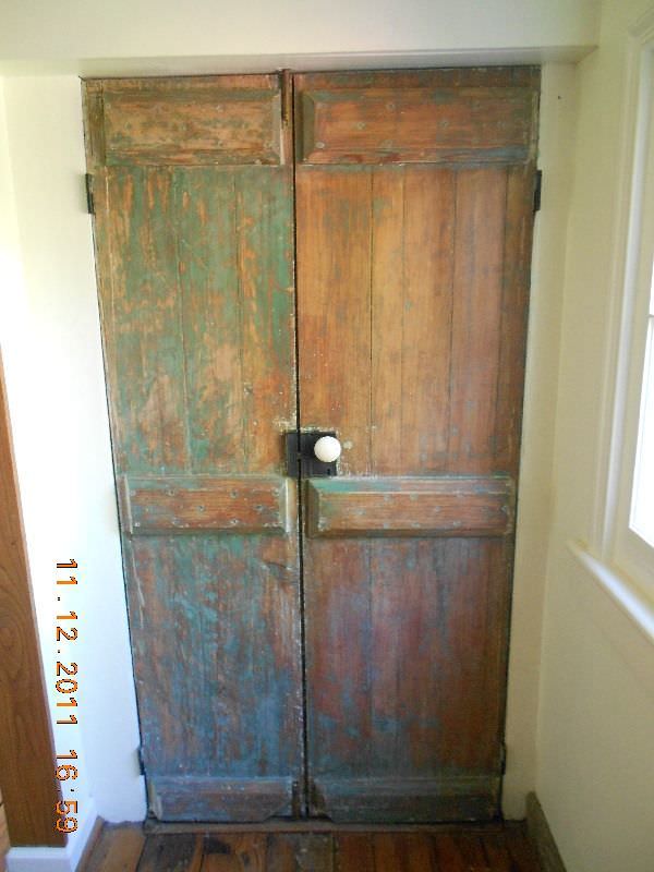

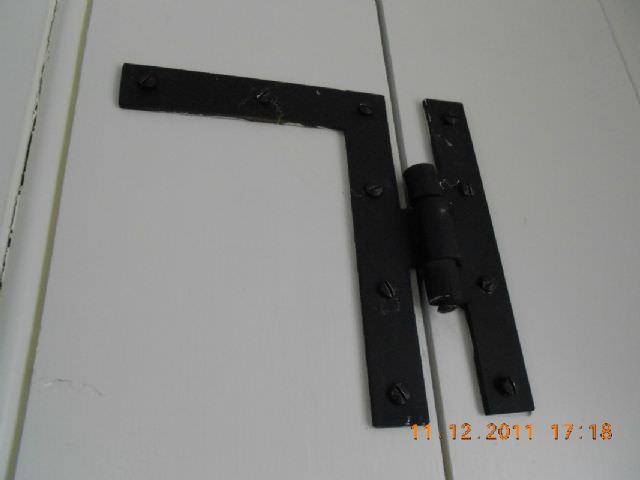

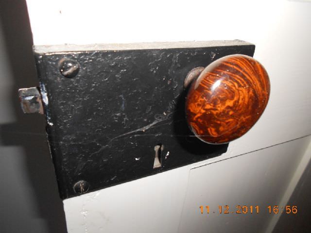

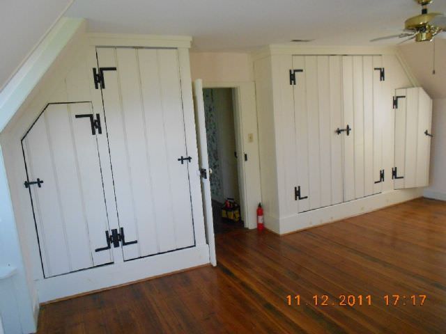

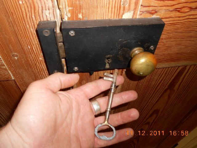

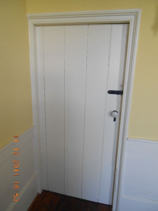

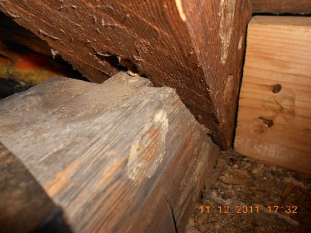

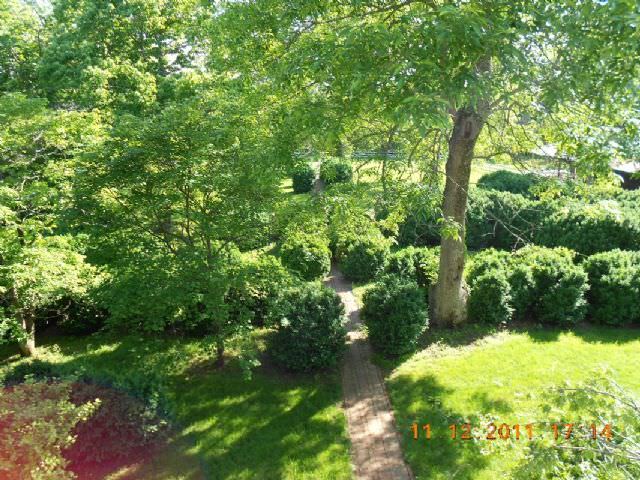

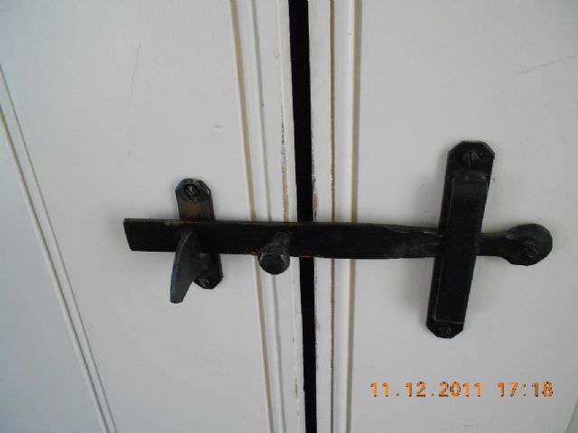

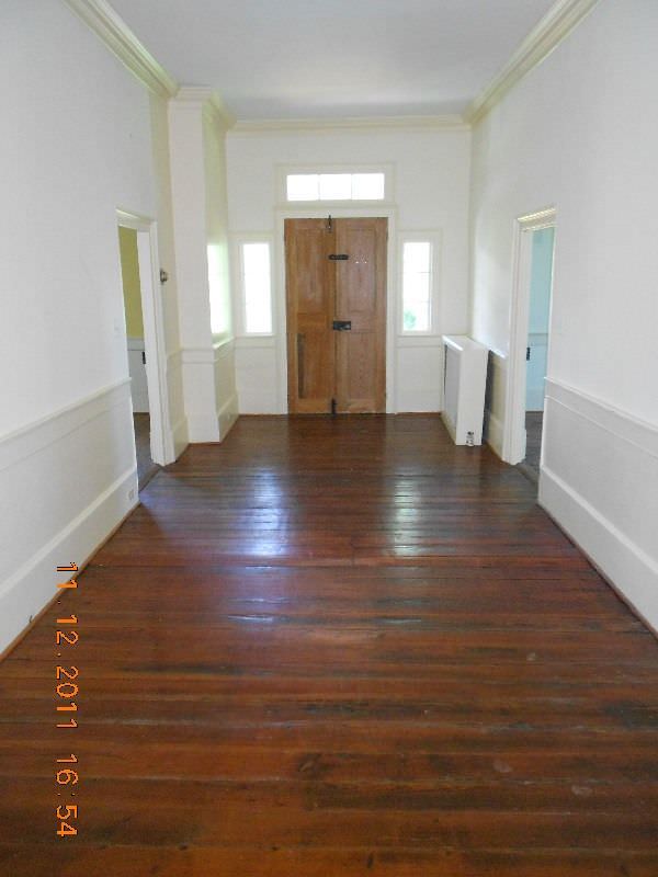

mgbinspect Posted May 19, 2011 Report Share Posted May 19, 2011 Here are some architectural and hardware highlights of a home I inspected yesterday built in 1764. The average height of the doors was about 73" +/- Click to Enlarge 72.76 KB Click to Enlarge 81.17 KB The old hand dug and brick lined well. She's slowly caving in. Click to Enlarge 59.28 KB The kitchen fireplace in the basement with a crane and a brick oven on the side: Click to Enlarge 42.81 KB Click to Enlarge 53.19 KB Click to Enlarge 32.75 KB Click to Enlarge 36.13 KB Floor framing: Click to Enlarge 27.09 KB Click to Enlarge 73.14 KB Click to Enlarge 33.75 KB Click to Enlarge 57.02 KB The front door and Foyer, which extends through the center of the home from the front to the back door and out to an english garden: Click to Enlarge 59.48 KB Click to Enlarge 52.09 KB Click to Enlarge 111.42 KB Random cool hardware: Click to Enlarge 35.68 KB Click to Enlarge 153.8 KB Click to Enlarge 53.46 KB Click to Enlarge 46.17 KB Click to Enlarge 24.65 KB Click to Enlarge 19.3 KB The door to the side porch: Click to Enlarge 64.73 KB Click to Enlarge 36.83 KB And some random interior shots: Click to Enlarge 30.89 KB Click to Enlarge 53.93 KB Click to Enlarge 36.82 KB Click to Enlarge 44.7 KB (Wood valance) Click to Enlarge 62.12 KB Click to Enlarge 41.83 KB Click to Enlarge 57.96 KB Click to Enlarge 34.68 KB Views from the upper windows: Click to Enlarge 45.01 KB Click to Enlarge 67.33 KB Quote Link to comment Share on other sites More sharing options...
Ben H Posted May 19, 2011 Report Share Posted May 19, 2011 Hand cut rabbits, and M&T's in the framing. Too cool. Quote Link to comment Share on other sites More sharing options...
mgbinspect Posted May 19, 2011 Author Report Share Posted May 19, 2011 Hand cut rabbits, and M&T's in the framing. Too cool. Indeed - second time I've seen this setup in the last forty-five days or so. I don't know how or why, but I'm not complaining. I love these old homes, from top to bottom. [:-wiltel] Quote Link to comment Share on other sites More sharing options...

John Kogel Posted May 19, 2011 Report Share Posted May 19, 2011 That's 120 years older than any building in my territory. What is the foundation like? Stone and mortar? I guess you could still call that an English garden in 1764. The Boston Tea Party was in 1773. [] Quote Link to comment Share on other sites More sharing options...

John Kogel Posted May 20, 2011 Report Share Posted May 20, 2011 I think I've seen similar doorknobs made from glass or possibly a Bakelite-type material. Early 20th C. Also the doorlatches in some pic, the square type that screws to the side of the plank door, were common here in the 1920's-30's. I can picture American bricks going back to England. That would be when the tall ships would need something for ballast, besides gold bars. [] Quote Link to comment Share on other sites More sharing options...
Bill Kibbel Posted May 20, 2011 Report Share Posted May 20, 2011 Bill, do you think ANY of the hardware or doors shown are original? I'd ESPECIALLY like to hear your thoughts about the brown wood-like door knob. (I've never seen one before!) And, the double doors to the front side porch - (equally unusual, for me). And, for that matter, what are your thoughts about the cast iron or wrought iron fire-screen? I assume that came on the scene much later?There's no hardware there that dates back to the presumed date of original construction. The box locks are the type from the latter part of the 19th century. The fireplace grate is as well. The fireplace crane and beehive oven door are recent, awful attempts at reproductions. Cranes weren't even created until after 1785 and were extremely rare. They are almost always added later to 18th century homes as an attempt to return to it's "colonial" appearance. The HL hinges and latch are store-bought, mass-produced reproductions. None of the doors in the pictures are original. The sidelights flanking the entrance were added later. There's a lot of wood components in and on the home that I suspect were added much later too. Quote Link to comment Share on other sites More sharing options...

Bill Kibbel Posted May 20, 2011 Report Share Posted May 20, 2011 I see quite a lot in the pictures you posted that would support the declared date of construction. It's not an authentically restored living history museum. It was a home to many families of several generations, each with their own ideas of what should be a part of the house. Quote Link to comment Share on other sites More sharing options...
