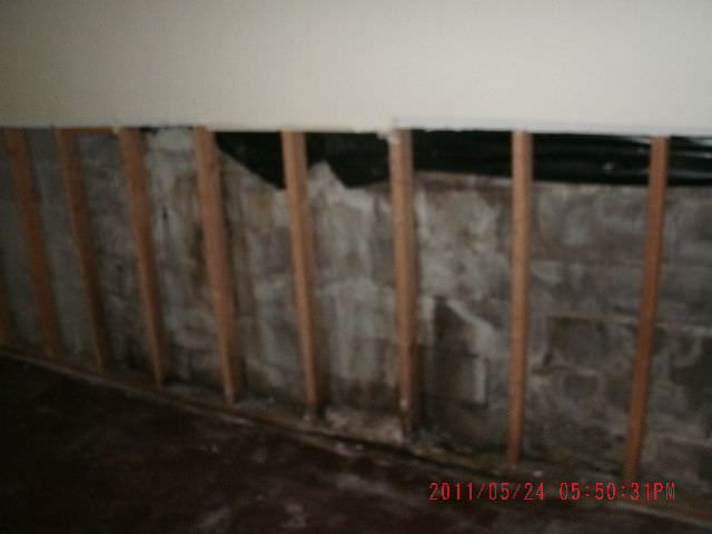

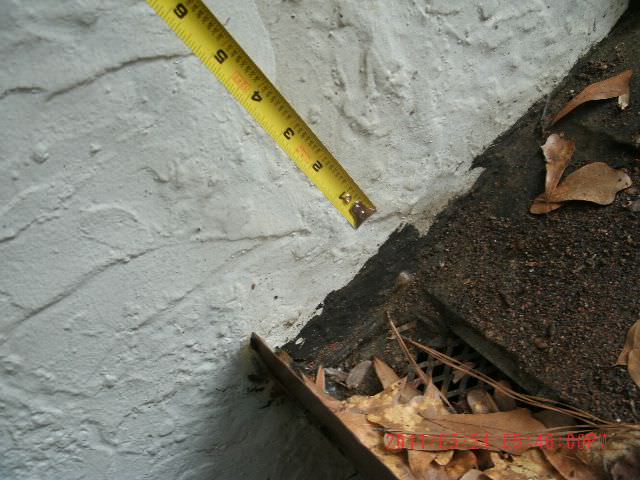

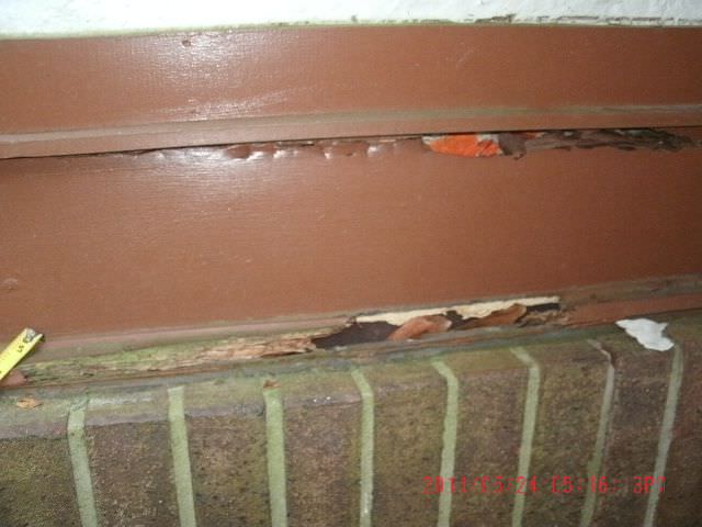

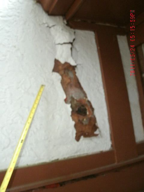

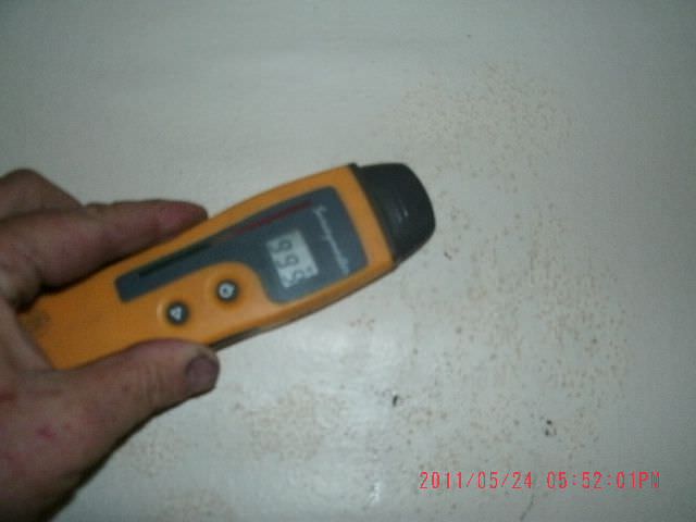

Phillip Posted May 27, 2011 Report Share Posted May 27, 2011 And there are realtors and builders around here that want to know why I call out the missing kick out. Click to Enlarge 67.21 KB Click to Enlarge 30.82 KB Click to Enlarge 46.71 KB Click to Enlarge 30.54 KB Click to Enlarge 29.81 KB Quote Link to comment Share on other sites More sharing options...
mthomas1 Posted May 27, 2011 Report Share Posted May 27, 2011 You can also send them here: Kick out flashing FAQ Quote Link to comment Share on other sites More sharing options...
AHI in AR Posted May 27, 2011 Report Share Posted May 27, 2011 Unfortunately, in similar cases I often see "repairs" done on damaged siding and trim which consist of simply rebuilding with the same defective design. Rarely does anyone seem to stop and question why the original installation failed. Quote Link to comment Share on other sites More sharing options...
