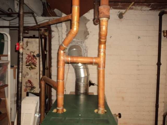

Neal Lewis Posted June 3, 2011 Report Share Posted June 3, 2011 The risers on this steam boiler have this strange cross piece. There is no header. Clearly, this installer didn't know how to pipe a steam boiler. What effeect, if any, do you think this piping arrangement will have on the system? Click to Enlarge 40.65 KB Quote Link to comment Share on other sites More sharing options...
Bill Kibbel Posted June 3, 2011 Report Share Posted June 3, 2011 The 2 steam mains are directly aligned with the 2 risers from the boiler. A proper manifold configuration has the mains connected to the manifold between the risers and the equalizer. Also, swing joints need to be installed to offset the manifold from the risers. The installation in your picture will result in the pressure in the header (supply side) and the return side of the boiler not being equal. Water won't stay in the boiler. Quote Link to comment Share on other sites More sharing options...

Neal Lewis Posted June 3, 2011 Author Report Share Posted June 3, 2011 Thanks Bill. Yeah, I didn't see at first that the equalizer is connected to only one of the mains. And not even connected in the right place. Quote Link to comment Share on other sites More sharing options...

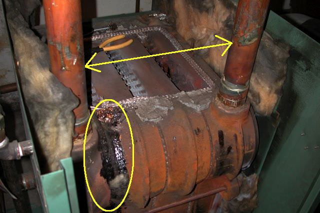

Kyle Kubs Posted June 8, 2011 Report Share Posted June 8, 2011 Peerless boiler? Copper should never be used for steam boiler piping, especially the header/manifold. The first thing that is going to happen is, without any swing joints in place, something you can't have with soldered Copper pipe, the thermal expansion, which is more significant with Copper than Iron, is going to cause that horizontal pipe to pry apart the sections of the heat exchanger, causing a leak. Kinda like this one. Click to Enlarge 51.58 KB That boiler look familiar? Then the Galvanic corrosion from the Copper and Cast Iron in the presence of water & O2 is going to rot the heat exchanger in about half the time is should live. I had told this guy ten years before he better get someone to change that piping. This one failed at the ripe young age of 18 years. Probably had a hole in it for a year before he called me. Click to Enlarge 30.32 KB The one you have there was piped by a buffoon. Quote Link to comment Share on other sites More sharing options...
