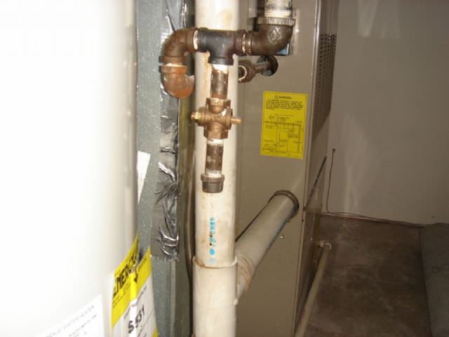

Bain Posted June 17, 2011 Report Share Posted June 17, 2011 . . . did someone think having a valve would make the sediment trap easier to clean or something similarly inane? I've never seen this before. (And if anyone asks whether I noticed that the valve was closed, I'm gonna kick him square in the ass.) Click to Enlarge 31.93 KB Quote Link to comment Share on other sites More sharing options...

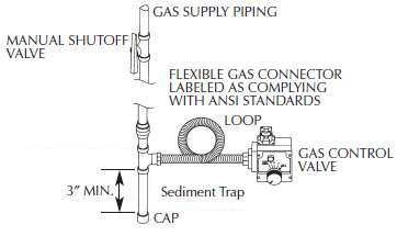

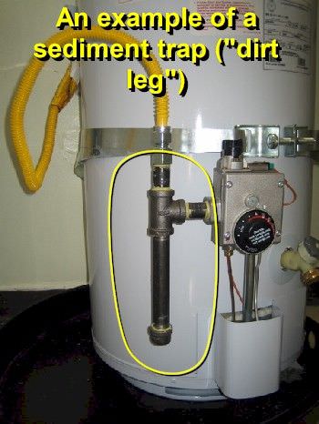

Richard Moore Posted June 17, 2011 Report Share Posted June 17, 2011 I would say you are missing a sediment trap and, instead, have a valved and capped off tee for a future appliance. I'll dig out my books, but I thought a sediment trap had to be configured as in the diagram or photo in order to be (most) effective. Click to Enlarge 13.05 KB Click to Enlarge 34.28 KB Quote Link to comment Share on other sites More sharing options...
AHI in AR Posted June 17, 2011 Report Share Posted June 17, 2011 I'd say you have a sediment trap, albeit a very small one. As Richard said, I think the plan was for a future gas appliance to be added. Quote Link to comment Share on other sites More sharing options...
kurt Posted June 17, 2011 Report Share Posted June 17, 2011 I see a lot of stuff tapped onto drip legs. So, my vote is for just stupid. Quote Link to comment Share on other sites More sharing options...
John Kogel Posted June 17, 2011 Report Share Posted June 17, 2011 I've never seen this before. Thanks, John. Now we can all say, yes, we've seen that before, if we ever see it agin. The valve is there to keep the trap from leaking, kind of a double trap. It's a good place as any to store extra plumbing parts. The plumber needed to clock another hour to fill up his day. He knew there had to be a valve on that line, but he couldn't remember where. Quote Link to comment Share on other sites More sharing options...
