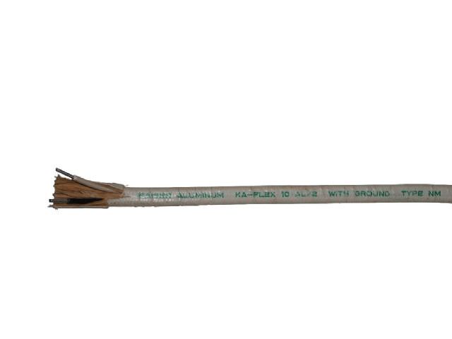

Richard Moore Posted July 9, 2011 Report Share Posted July 9, 2011 Just to throw in another option...is it possible that those rag wrapped cables are tinned copper and not aluminum? All the solid Al I've seen, as well as photos online, had plastic cable covering. Did they make a rag wrap solid aluminum cable? Quote Link to comment Share on other sites More sharing options...
Douglas Hansen Posted July 9, 2011 Report Share Posted July 9, 2011 RM: Did they make a rag wrap solid aluminum cable? DH: Yes - see attached photo Click to Enlarge 10.71 KB Quote Link to comment Share on other sites More sharing options...
Richard Moore Posted July 9, 2011 Report Share Posted July 9, 2011 Thanks Doug. I now knows more better. Quote Link to comment Share on other sites More sharing options...
