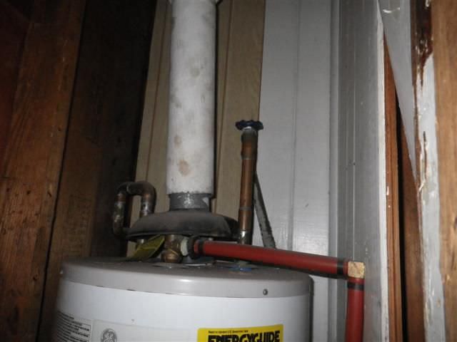

palmettoinspect Posted July 9, 2011 Report Share Posted July 9, 2011 No dryer in this house so I guess the next best thing is the asbestos water heater vent. Click to Enlarge 27.94 KB Click to Enlarge 34.25 KB Quote Link to comment Share on other sites More sharing options...
Brandon Whitmore Posted July 9, 2011 Report Share Posted July 9, 2011 Looks like they're trying to burn not only the towels, but the relief pipe as well. Quote Link to comment Share on other sites More sharing options...
John Kogel Posted July 9, 2011 Report Share Posted July 9, 2011 Why does that vent hood look like a toilet plunger, and why is it jammed on top of the TPRV? That is an electric water heater, no? Quote Link to comment Share on other sites More sharing options...
hausdok Posted July 9, 2011 Report Share Posted July 9, 2011 Why does that vent hood look like a toilet plunger, and why is it jammed on top of the TPRV? That is an electric water heater, no? No, It's a gas water heater but that doesn't look like the proper hood for that water heater. I'm guessing that they used the one from the previous water heater because the vent was jammed up into that asbestos pipe already. Of course, who knows why some folks do things? ONE TEAM - ONE FIGHT!!! Mike Quote Link to comment Share on other sites More sharing options...

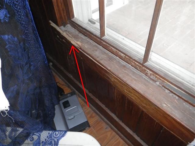

palmettoinspect Posted July 10, 2011 Author Report Share Posted July 10, 2011 Why does that vent hood look like a toilet plunger, and why is it jammed on top of the TPRV? That is an electric water heater, no? Nope, natural gas. It's a mess I know. You should see the rest of the home. Here's another picture for your enjoyment. So much termite damage. All interior walls and ceiling are wood. Click to Enlarge 48.92 KB Quote Link to comment Share on other sites More sharing options...
