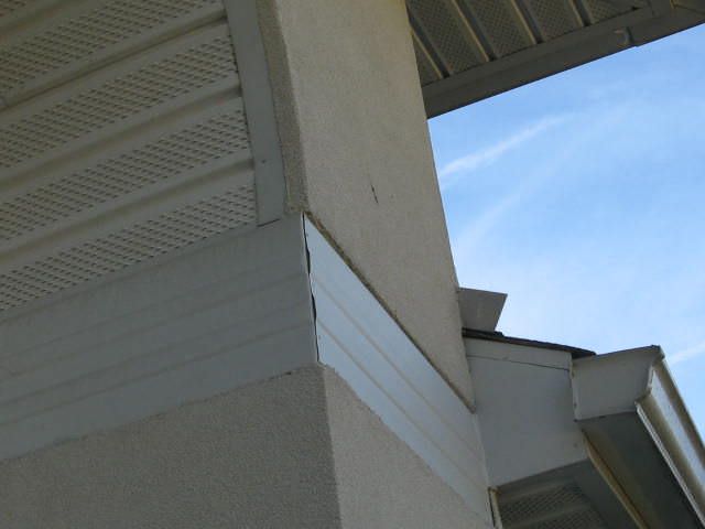

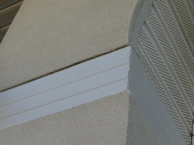

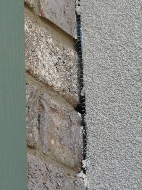

Terence McCann Posted July 14, 2011 Report Share Posted July 14, 2011 The installation is wrong in so many ways but need to make sure what material the siding is (EIFS is rare in this neck of the woods). This was only on the front entry part of the home. The rest of the home was brick and vinyl. Click to Enlarge 40.96 KB Click to Enlarge 29.59 KB Click to Enlarge 75.92 KB Quote Link to comment Share on other sites More sharing options...
Inspectorjoe Posted July 14, 2011 Report Share Posted July 14, 2011 Terry, yes it's EIFS (not EFIS). The reinforcing mesh in picture #3 is the biggest clue, but of course you shouldn't be seeing it there. Quote Link to comment Share on other sites More sharing options...

Marc Posted July 14, 2011 Report Share Posted July 14, 2011 Cement board stucco also uses a mesh but employs no XPS foam so it's not considered EIFS. I differentiate between cement board and EIFS by pressing gently on a flat surface. EIFS deflects slightly, cement board stucco does not. Many installations around here are cement board stucco with XPS foam for trim. The same mesh and top coat are used on both. Top coat is a polymer improved version of cementitious finishes. Marc Quote Link to comment Share on other sites More sharing options...
