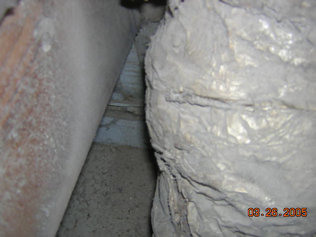

rlskfoster Posted March 28, 2005 Report Share Posted March 28, 2005 hey HVAC gurus I have a couple of questions I'm hoping someone can help with. I inspected a house yesterday with a gas heat thet was located in an upstairs hallway. The return air had a large wrapped A/C duct that took up at least half of the chase not to mention all the dirt and dust that was caked up on it. is this allowed? The unit actually sat at floor level and the return chase was boxed under it. It was pulling air from the hallway below. Another thing i was worried about was the use of the metallic duct tape around one joint of the flue. I did not know if iy was approved for this or not. I appreciate any thoughts. Thanks Buster Quote Link to comment Share on other sites More sharing options...
Jim Katen Posted March 28, 2005 Report Share Posted March 28, 2005 Originally posted by rlskfoster hey HVAC gurus I have a couple of questions I'm hoping someone can help with. I inspected a house yesterday with a gas heat thet was located in an upstairs hallway. The return air had a large wrapped A/C duct that took up at least half of the chase not to mention all the dirt and dust that was caked up on it. is this allowed? Just so I've got this right, the return air chase had an AC duct run through it? No, that's not right. Presumably, someone at one time sized that return air chase to meet the needs of the system. If there's now a duct running through it or across it or whatever, that's reduced the size of the return air path. The unit actually sat at floor level and the return chase was boxed under it. It was pulling air from the hallway below. Nothing wrong with that. Another thing i was worried about was the use of the metallic duct tape around one joint of the flue. I did not know if iy was approved for this or not. I appreciate any thoughts. Thanks Buster No. As far as I know, metallic duct tape is not supposed to be used on vents or vent connectors. To be sure, you'd have to find the manufacturer's specs. - Jim Katen, Oregon Quote Link to comment Share on other sites More sharing options...
rlskfoster Posted March 28, 2005 Author Report Share Posted March 28, 2005 Thanks Jim, I will day figure how to load a picture and it would be easier to see what i was seeing. The duct filled such a large part of the return I just had to believe it would compromise the system. I did write both the tape on vent duct and the return up and advised to consult an HVAC tech. Thanks for the help and if i figure this out today i'lll load a picture. (computer challenged person driving this keyboard!) Buster Quote Link to comment Share on other sites More sharing options...
rlskfoster Posted March 28, 2005 Author Report Share Posted March 28, 2005 I think I have this loaded right. This is the return air and the duct sits right in the middle of everything. Buster Download Attachment: Pointer2 010.jpg 73.68 KB Quote Link to comment Share on other sites More sharing options...
