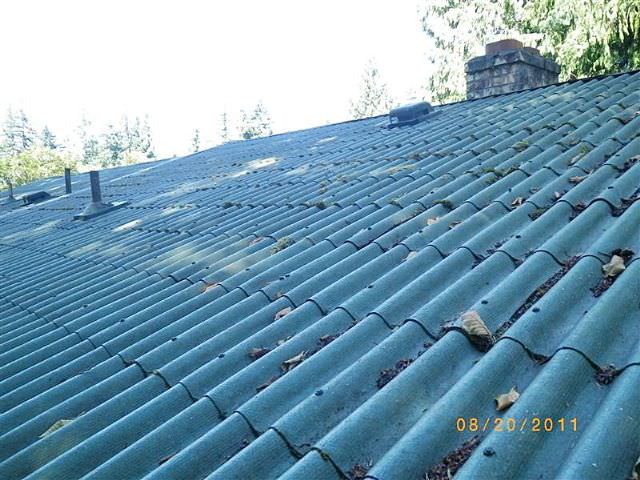

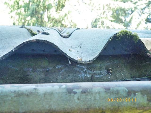

Robert Jones Posted August 20, 2011 Report Share Posted August 20, 2011 This home was built in 1980 although I am fairly certain this roof covering has been added after that. It seems to be a fiberglass type material? Anyway, first time for me . Can anyone advise me as to the material type so I can research it a bit. Thanks. Click to Enlarge 79.84 KB Click to Enlarge 56.29 KB Click to Enlarge 72.08 KB Click to Enlarge 50 KB Quote Link to comment Share on other sites More sharing options...
Jim Katen Posted August 20, 2011 Report Share Posted August 20, 2011 Ondura. Quote Link to comment Share on other sites More sharing options...

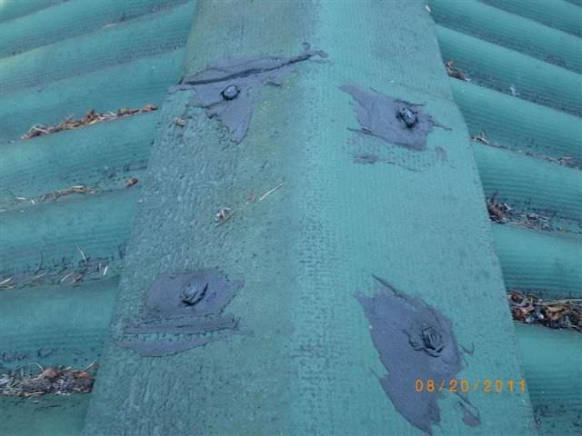

Robert Jones Posted August 20, 2011 Author Report Share Posted August 20, 2011 Have you read or heard any negative feedback on the material? One thing I noticed was that almost all the nail heads were in need of sealant and the foam ridge vent closure strips were everywhere(loose). Quote Link to comment Share on other sites More sharing options...

Robert Jones Posted August 20, 2011 Author Report Share Posted August 20, 2011 I have added another pic to show the nail heads at the ridge cap. It was like this all over the roof. The sealant was cracked and brittle. Quote Link to comment Share on other sites More sharing options...

Bill Kibbel Posted August 22, 2011 Report Share Posted August 22, 2011 This home was built in 1980 although I am fairly certain this roof covering has been added after that. It seems to be a fiberglass type material? Anyway, first time for me . Can anyone advise me as to the material type so I can research it a bit. Thanks. It's not fiberglass, but bitumen saturated paper pulp. The same material and process as Orangeburg pipe. I have seen enough issues with it to be quite comfortable telling folks it's a below agricultural-building grade roof covering. I don't know of any quality building supply yards that will stock it. It's in the home centers though, for cheap-ass DIYers. Quote Link to comment Share on other sites More sharing options...

Les Posted August 23, 2011 Report Share Posted August 23, 2011 Can't agree with my fellows. Yes it was/is inexpensive but not easy to properly install. Temps made a great deal of difference. Do not install it on a cool morning in the summer, it will rack and squirm all over the place. Do not walk on it. It will break or crack. It is slicker than metal when damp. I used it on several houses back in the 80's. It is pleasing to look at and very quiet. Rustic. Easy to cut and fit. I used screws on one roof and nailed all the others. Well, I didn't really do anything other than watch, drink coffee and tell stories about building the Maginot Line. I would not use it again. The roofs are still functional, but all have swollen sections of material. Quote Link to comment Share on other sites More sharing options...
