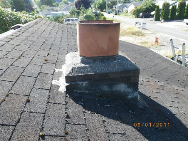

Robert Jones Posted September 2, 2011 Report Share Posted September 2, 2011 This "chimney" is servicing a wood stove. Looks to be too short to me. Is that close enough to the ridge to use the 2 ft rule? Click to Enlarge 82.37 KB Quote Link to comment Share on other sites More sharing options...
Tim Maxwell Posted September 2, 2011 Report Share Posted September 2, 2011 It looks to be above the ridge from the picture. I bet it works fine. No sooty mess around the top like it has been a problem. Quote Link to comment Share on other sites More sharing options...
hausdok Posted September 2, 2011 Report Share Posted September 2, 2011 Hi Robert, Here's what probably happened. The crown on the original stack cracked and infiltration turned the top of that stack into an unsteady pile of Jenga blocks. The owner got an estimate, said, "What! That's too G__D____ much to pay to rebuild the top of that stack; I'll fix it myself," and he then went out, bought a bag of Sackrete and set to work throwing away all of the loose bricks and troweling on the existing crown. When he got done he congratulated himself on how he outwitted those crooks who call themselves brick masons. I'd tell 'em it needs to be restored to it's original condition and height. ONE TEAM - ONE FIGHT!!! Mike Quote Link to comment Share on other sites More sharing options...
John Kogel Posted September 2, 2011 Report Share Posted September 2, 2011 It needs to be 2 feet taller than any roof surface within a 10 foot radius. It appears to be too short for a wood-burner. [:-magnify Eye wood collet. [] Quote Link to comment Share on other sites More sharing options...

Jim Katen Posted September 2, 2011 Report Share Posted September 2, 2011 This "chimney" is servicing a wood stove. Looks to be too short to me. Is that close enough to the ridge to use the 2 ft rule? It has to meet the 3' rule before you even get to the 2' rule. Quote Link to comment Share on other sites More sharing options...
Brandon Whitmore Posted September 3, 2011 Report Share Posted September 3, 2011 Yeah, that things not even close to the 3-2-10 rule. Quote Link to comment Share on other sites More sharing options...

Hearthman Posted September 6, 2011 Report Share Posted September 6, 2011 3/2/10 plus the cross-sectional area of the flue cannot exceed 3x the cross-sectional area of the appliance collar. Should have a level II inspection as it probably needs a listed liner. Quote Link to comment Share on other sites More sharing options...
