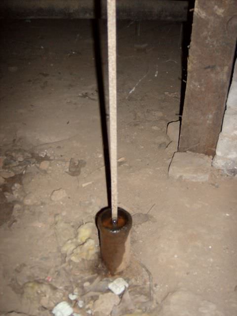

Jim Baird Posted September 9, 2011 Report Share Posted September 9, 2011 A square steel shaft, approx half inch, descends from bath or kitchen group into steel pipe in crawlspace soil. Under fixture group that was active the receiving pipe brimmed with water, under the one cut off it was dry. House built in '20's, cast iron drain and galv supply. Never seen this and don't know what to call it. Click to Enlarge 39.73 KB Click to Enlarge 37.1 KB Quote Link to comment Share on other sites More sharing options...

Jim Baird Posted September 9, 2011 Author Report Share Posted September 9, 2011 Hey Les, I don't feel compelled to call it anything. Prospective buyer has a gut and rebuild mindset anyway. In both locations it had the look of a cutoff stem, but as we have said elsewhere, we don't turn no cutoffs around here. At neither place was there anything noticeable above the floor, though this house, like some, was overendowed with piles and stacks of the former occupant's (deceased) stuff, which stuff limits access considerably. Quote Link to comment Share on other sites More sharing options...
inspector57 Posted September 9, 2011 Report Share Posted September 9, 2011 It was common in that era around these parts to have underground "stop and waste" valves with the square steel handle extending to or above the floor inside the house. Of course stop and waste valves are no longer allowed and pipes must be protected from freezing (insulated.) Quote Link to comment Share on other sites More sharing options...

Erby Posted September 10, 2011 Report Share Posted September 10, 2011 Saw one last week. Accessible inside the house in the closet floor. Guess they didn't like to enter crawl spaces to shut water off. You ever notice on more modern house that if the shut off is in the right front corner of the crawl, the entrance is like at the left rear ( or vice versa). Quote Link to comment Share on other sites More sharing options...
