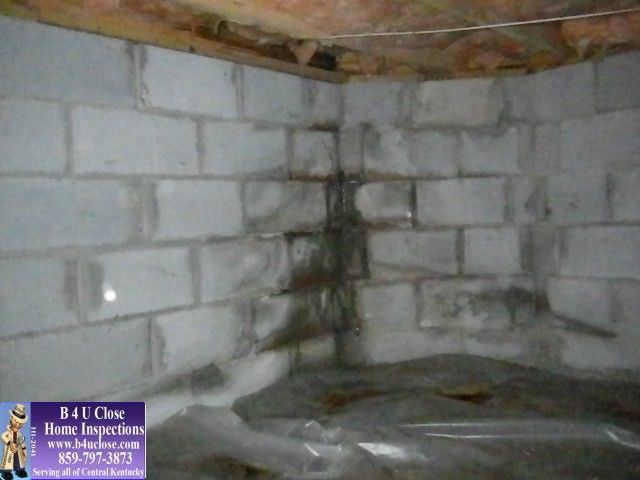

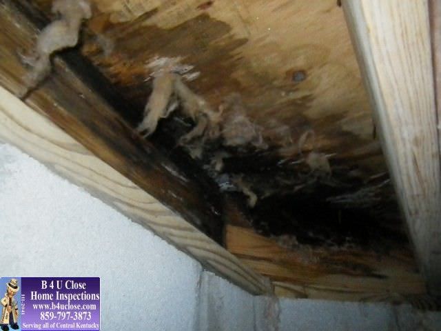

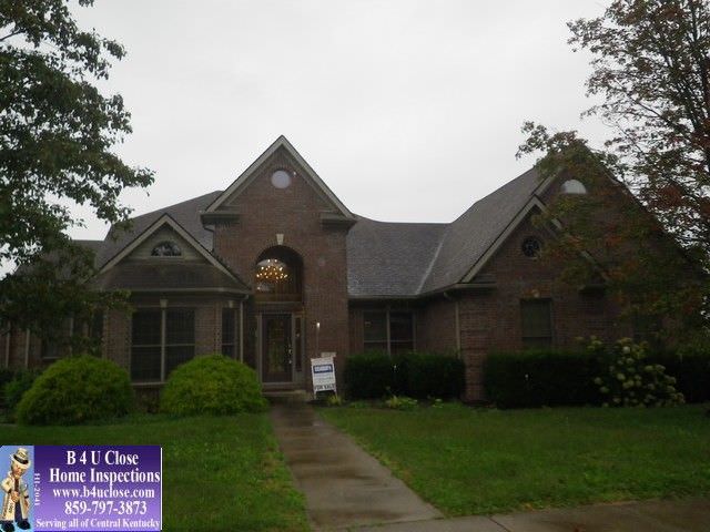

Erby Posted September 21, 2011 Report Share Posted September 21, 2011 What difference does it make if water runs down the brick instead of into the gutter. Front view Click to Enlarge 57.13 KB Kick out flashing isn't quite doing the job Click to Enlarge 66.58 KB In the crawl space under the area Click to Enlarge 40.37 KB Why it's worth pulling back the insulation Click to Enlarge 46.23 KB For some reason, I always have a big sigh of relief when I find this kind of stuff. Maybe because I know it won't come back to bite me because I didn't find it. - Quote Link to comment Share on other sites More sharing options...

Erby Posted September 22, 2011 Author Report Share Posted September 22, 2011 Concrete crawl space floors are rare here in Kentucky. Almost all are dirt or pea gravel over dirt covered with plastic vapor barrier. - Quote Link to comment Share on other sites More sharing options...
