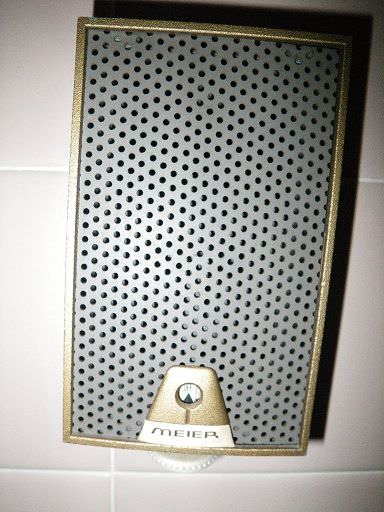

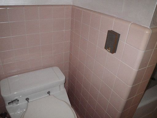

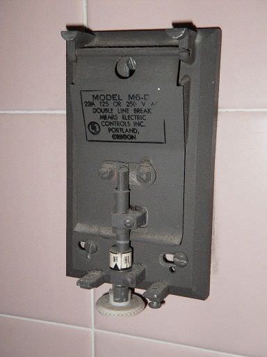

Garet Posted September 21, 2011 Report Share Posted September 21, 2011 Found this in a 1950s -1960s bathroom. It had an exhaust fan over the throne, with a somewhat newer count-down timer control on the opposite wall. Google turned up nothing. Any ideas? Click to Enlarge 26.7 KB Click to Enlarge 54.24 KB Click to Enlarge 28.02 KB Quote Link to comment Share on other sites More sharing options...
Les Posted September 21, 2011 Report Share Posted September 21, 2011 thermostat. usually radiant heat. Likely regional. also can be used as a colon stimulator with addition of couple pigtail clips. Quote Link to comment Share on other sites More sharing options...
allseason Posted September 21, 2011 Report Share Posted September 21, 2011 Looks like an electric heat source control. What happened when you turned it up? Quote Link to comment Share on other sites More sharing options...
Jim Katen Posted September 21, 2011 Report Share Posted September 21, 2011 In my area, those stats are used to control radiant ceiling heat. Quote Link to comment Share on other sites More sharing options...
kurt Posted September 21, 2011 Report Share Posted September 21, 2011 In my area, those stats are used to control radiant ceiling heat. Same here. I'd be looking for some electric drywall. Quote Link to comment Share on other sites More sharing options...
Garet Posted September 21, 2011 Author Report Share Posted September 21, 2011 Looks like an electric heat source control. What happened when you turned it up? Nothing, as far as I could tell. It was already a long inspection, so I didn't want to spend a lot of time running between there and the panel. Thanks everyone for your input. Quote Link to comment Share on other sites More sharing options...

Erby Posted September 22, 2011 Report Share Posted September 22, 2011 I agree with ceiling heat. Don't know why you'd be running back and forth to the panel. Just crank it up, go on for a while and come back to use your infrared thermometer to see if there's any temperature differential in the ceiling drywall. Around here I usually get readings of about 115 - 120 after cranking em up. - Quote Link to comment Share on other sites More sharing options...
Brandon Whitmore Posted September 22, 2011 Report Share Posted September 22, 2011 No wonder I see these exact 'stats all of the time-- they were made right here in OR. Quote Link to comment Share on other sites More sharing options...
hausdok Posted September 22, 2011 Report Share Posted September 22, 2011 I see them all the time. Not just with ceiling radiant but with all sorts of electrical heaters. ONE TEAM - ONE FIGHT!!! Mike Quote Link to comment Share on other sites More sharing options...
