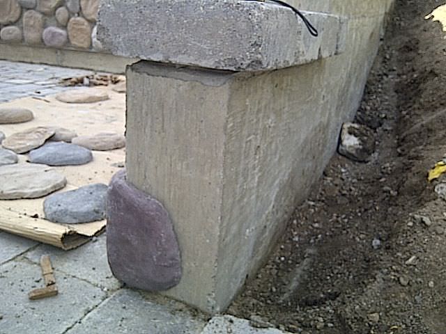

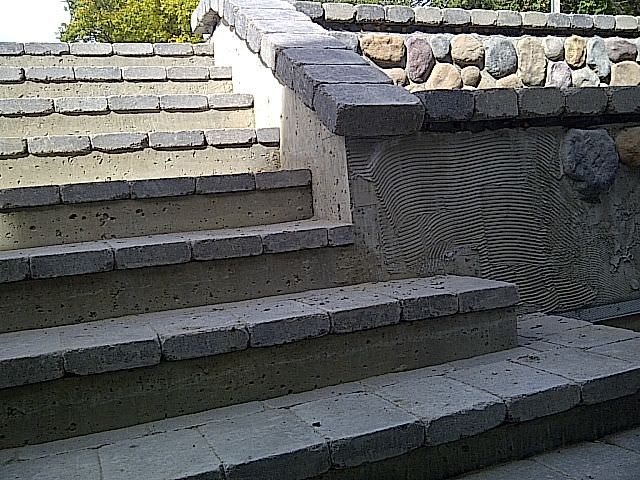

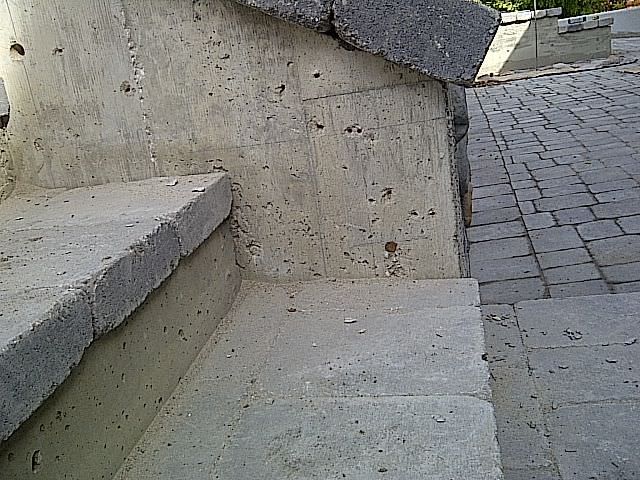

Shawnsback Posted September 23, 2011 Report Share Posted September 23, 2011 So this flower bed turned from one side to two sides, then stairs, curvy walls and all the silly changes as the year progressed. Everything is concrete including the stairs. 4 inch thick patio blocks have been installed as cap stones and as the treads on the stairs. My concern is installing the stone around the treads of the stairs properly. Click to Enlarge 98.68 KB I was thinking maybe install a J weep or something 1.5 inches or so away from the risers and the treads. Have stucco (or just the unfinished concrete) underneath that and give the blocks some space. plus is it a good idea to grout and tie the mortar into the patio blocks? (PL'd) I doubt it. Click to Enlarge 97.39 KB Dealing with the annoying roundness or river rock, what is the common practice to terminating the stone/mortar and transitioning to stucco properly? they now want stucco to meet up with the stone somehow. kinda like this Click to Enlarge 69.22 KB well hope I did better on this post...Im still learning how to explain myself better. Thanks for reading Shawnsback Quote Link to comment Share on other sites More sharing options...

kurt Posted September 24, 2011 Report Share Posted September 24, 2011 Thanx Nolan..... There's more problems coming to that install than I can list. At least, that's what it looks like to me. Anyone think I'm off base here? Quote Link to comment Share on other sites More sharing options...
Tom Raymond Posted September 24, 2011 Report Share Posted September 24, 2011 No, it's crap. Expensive, heavy, difficult to remove crap. I don't see any drainage. All that fooked up concrete is going to blow up without drainage. Quote Link to comment Share on other sites More sharing options...
kurt Posted September 24, 2011 Report Share Posted September 24, 2011 Yeah, this idea (extremely prevalent in my 'hood) that one can simply glue pavers to concrete substrates, or almost as bad, simply bed them in sand, is entirely mistaken. It'll be running with stains in a year or so, and the concrete will blow up in about 5 years. Especially the stairs. All that fake stone coping should have flashing under it to keep water from migrating down into the wall. I'd give that a few more years than the stairs because the damage won't be as visible and folks won't have to walk on it. Joe L. should add this as the 11th item in his top ten list about how not to build in northern climates. This is what Troba was made for. Quote Link to comment Share on other sites More sharing options...
