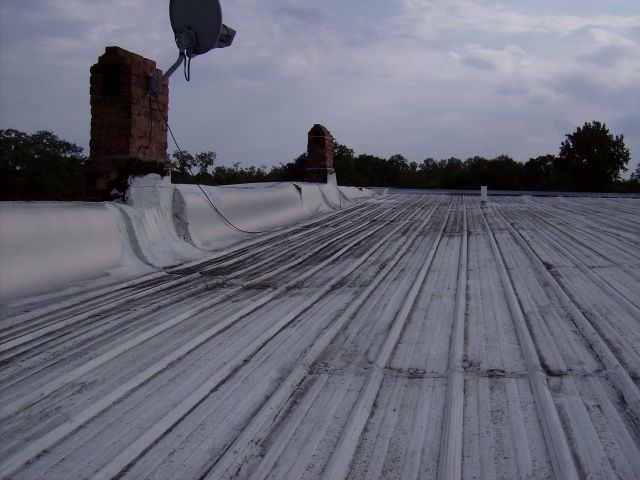

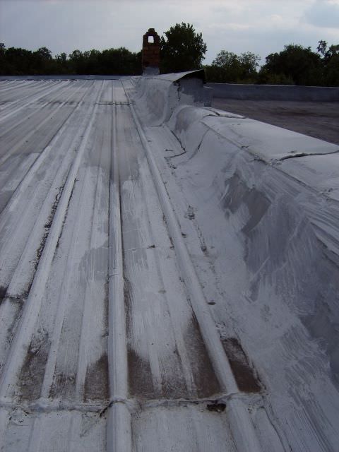

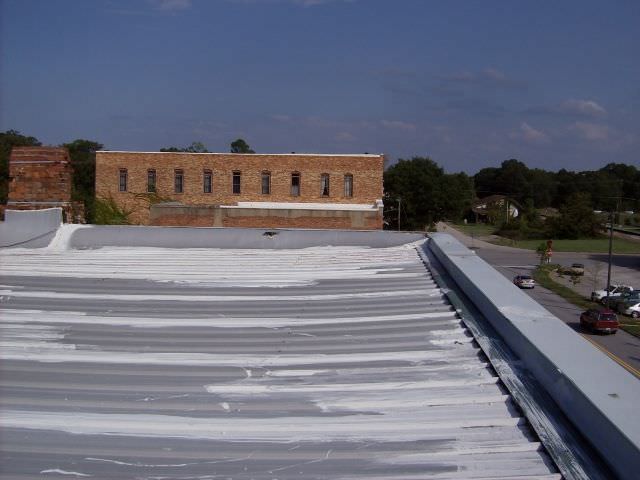

Jim Baird Posted September 28, 2011 Report Share Posted September 28, 2011 We don't need no stinkin' hot tar roofs now that we got these new metal sheets. Click to Enlarge 44.28 KB We slather the seams and even the end laps with so much caulk it makes the water stand. Click to Enlarge 46.95 KB Heck nobody ever comes up here anyway. Click to Enlarge 48.55 KB Quote Link to comment Share on other sites More sharing options...

Jim Baird Posted October 3, 2011 Author Report Share Posted October 3, 2011 The IBC says you can use this kind of roof cover down to a half-unit in twelve if you seal the seams according to manufacturer. My rough calc found slope at one-third unit in twelve, if you ignore the general rise and fall across width and length, like deep water ocean swells. So much goo on top of this one I have no clue as to whether seams were sealed underneath. I told the client one word hovered in my mind re this job, "botch". Later, my check of an old aerial photo showed there used to be three brick chimneys projecting from this building's roof area, which explains those high, hard humps I noticed under the feet. Quote Link to comment Share on other sites More sharing options...
