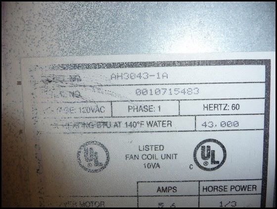

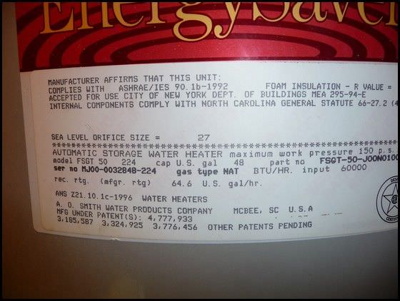

John Dirks Jr Posted October 28, 2011 Report Share Posted October 28, 2011 The water heater tag says input rating of 60,000 BTU. The furnace tag rating is 43,000 BTU. This confirms that water heater is big enough to supply the furnace, correct? I'm almost sure it does but the "input" method of rating the WH has me confused. Does the input rating of the WH indicate how much energy it can produce? If so, it would be less confusing to use the word "output", don't you think? Click to Enlarge 45.96 KB Click to Enlarge 55.96 KB Quote Link to comment Share on other sites More sharing options...
Marc Posted October 28, 2011 Report Share Posted October 28, 2011 By 'input' is meant the rate at which energy enters the appliance, expressed in BTU/hr. 'Input' is used here instead of 'output' because the manufacturer has no control over the conditions under which the appliance is operated. 'Output' is the product of 'input' and efficiency but the advertised efficiency is valid only when certain conditions are present, such as water supply temperature, exiting water temperature, entering combustion air temps, draft amounts, etc. If the operational conditions which results when the WH is installed and married to the furnace is not the same as the efficiency test conditions then you have a less than ideal union of the two, consequences of which include less than rated efficiency, reduced performance as well as differences-of-opinion, conflicts, arguments, fights and, in extreme mismatches, failure of the marriage. Since the exiting water from the water-to-air heat exchanger appliance is returned to the WH, it's efficiency approaches 100%. The margin by which the WH capacity exceeds the furnace capacity is good insurance of a good, performing marriage. Just my humble opinion. I've only been married for 11 years. Marc EDIT: corrections Quote Link to comment Share on other sites More sharing options...
John Dirks Jr Posted October 28, 2011 Author Report Share Posted October 28, 2011 Thanks Marc, I understand the expanded explanation. Quote Link to comment Share on other sites More sharing options...
John Kogel Posted October 28, 2011 Report Share Posted October 28, 2011 Ideally, that heater can produce 64 gals of hot water/hour. It has a recovery rating of 64 gals of hot water/hour. 140 degrees is hot! How many gallons of water does your system hold? If it holds 16 gallons, you can have a hot floor in 15 mins. Or a warm floor in 12 minutes, agreed? Quote Link to comment Share on other sites More sharing options...
