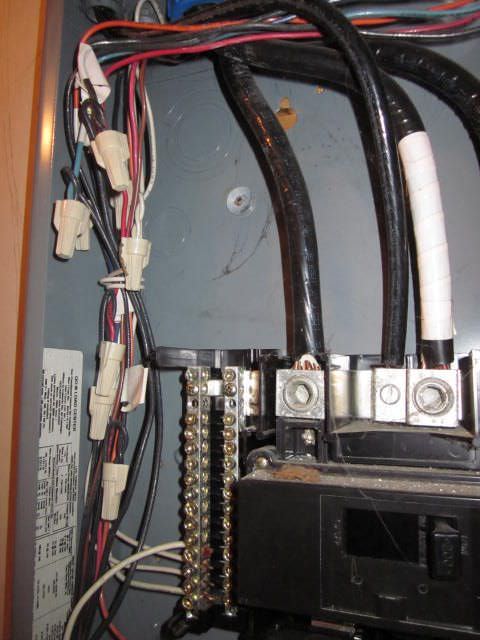

Mike Lamb Posted November 13, 2011 Report Share Posted November 13, 2011 This 20 year old panel had 15 pigtails because the wires were not long enough to reach the breakers. I don't believe this an issue other than some astonishingly bad electrical work. Maybe the wire nuts should be turned upwards? Thoughts? Click to Enlarge 54.41?KB Quote Link to comment Share on other sites More sharing options...
Erby Posted November 13, 2011 Report Share Posted November 13, 2011 Is it likely to be a panel upgrade with the new electrician trying to square things away but lacking sufficient wire length to do so, thus the pgtails? - Quote Link to comment Share on other sites More sharing options...
kurt Posted November 13, 2011 Report Share Posted November 13, 2011 That'd be my guess.....someone changed out the service, new panel location made old branch circuits too short, solution is pigtails. I'd probably point it out, but if everything else was OK, I don't see why it's a problem. Quote Link to comment Share on other sites More sharing options...
Mike Lamb Posted November 13, 2011 Author Report Share Posted November 13, 2011 Thanks. I didn't consider a new panel in a fairly new home. Quote Link to comment Share on other sites More sharing options...
Jim Port Posted November 13, 2011 Report Share Posted November 13, 2011 Properly installed wire nuts are not likely to fall off regardless of position. if gravity is the only thing stopping them from falling off you have greater issues. Quote Link to comment Share on other sites More sharing options...
