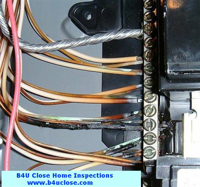

Brian G Posted May 27, 2005 Report Share Posted May 27, 2005 For the second time in my young career I've had an electrician refuse to correct multiple neutrals in one terminal and/or grounds & neutrals mixed in one terminal, in a main panel. Both said in writing that it was "common practice" and "not a potential hazard", and the second guy backs this with a phone call to a local AHJ who agreed with him (he says). I don't doubt the guy probably said it. I can't help wondering if these guys were paid to refuse to make the repair. I mean hell, you're hired to go to some house and correct the electrical stuff in an inspection report (the only such item in this case), but you go out there, have a look, and decide for yourself not to do it...but bill for your time anyway? How can I get a job where I refuse to do what's asked but still get paid? Anyway, could someone with the new NEC stuff post the exact part of the current code where they say you can't do this? And correct me if I'm wrong, but isn't that old "interpretation by the local AHJ" thing only where the code isn't clear or definitive? If it plainly says you "must" or "cannot", etc., can the local guy overule the code (technically speaking, of course)? Gotta love these guys...they know better than the people who make the equipment or those who write the NEC. I'm in such rarified company here...[:-dunce] Brian G. Miffed in Mississippi [:-irked] Quote Link to comment Share on other sites More sharing options...
DonTx Posted May 27, 2005 Report Share Posted May 27, 2005 I feel your pain Bro. At one time, uninsulated KT, 3 prong 220V outlets, 2 prong non grounded outlets were all common. (Still see a lot of 3 prong 220V outlets in new construction) I'm not sure if it's in the New NEC version or the old, but what I use is 110.14(a), the manufacturers sticker on the cabinet plus a UL listing which, I can not find right now but I'm sure someone has handy, perhaps Bro Katen or Douglas. Quote Link to comment Share on other sites More sharing options...
Erby Posted May 27, 2005 Report Share Posted May 27, 2005 Brian, it happens. All you can do is advise your client. The client has to make the final decision. Here's what I tell my clients about the disagreement issue. DIFFERING OPINIONS Don't be surprised when a contractor or real estate agent says something is okay when I said it isn't. Home inspectors are generalists conducting an essentially visual inspection and recommending specialists in the appropriate area for specific repairs. Some specialists, and other people, will disagree with my opinions. I always defer to specialists opinions, since as a matter of law, they are supposed to know more than I do. I've put my opinions in writing. I feel you should have those who disagree put their opinions in writing also. Ask them to include their license number, if applicable, and guarantee that the item is safe or OK to operate as it is. If they refuse to do so, you need to establish what weight to give each opinion. The one time I am aware that this happened, a plumber said a water heater was safe and would continue to operate OK when I said it wasn't and wouldn't. When he was asked to put it in writing he refused. The water heater was subsequently replaced. And here's a photo showing why two neutrals under one screw isn't a real good idea. Don't know the photo source. Show it to the client, electricians, AHJ. Download Attachment: BurnedNeutralsandBus2.jpg 92.51 KB 408.21 Grounded Conductor Terminations. Each grounded conductor shall terminate within the panelboard in an individual terminal that is not also used for another conductor. Exception: Grounded conductors of circuits with parallel conductors shall be permitted to terminate in a single terminal if the terminal is identified for connection of more than one conductor. Quote Link to comment Share on other sites More sharing options...
Brian G Posted May 27, 2005 Author Report Share Posted May 27, 2005 Originally posted by Erby Some specialists, and other people, will disagree with my opinions. I always defer to specialists opinions, since as a matter of law, they are supposed to know more than I do. That's a little farther than I can go Erby. I'm not deferring to specialist who's just plain wrong when I can prove it. The gentleman in question may have qualifications stretching from here to the coast and back, but he's wrong. 408.21 Grounded Conductor Terminations. Each grounded conductor shall terminate within the panelboard in an individual terminal that is not also used for another conductor. Question: Is an equipment ground considered a "conductor"? I remembered after posting the topic that this is actually the third time, but the guy in-between didn't put anything in writing. And at the risk of drift, I also had a HVAC contractor today who declined to install the correct size of breaker on a condenser unit. That one stunned me for a second or two...it's stamped right into the label fer cryin' out loud. Brian G. In the Land of Genius Contractors [:-boggled Quote Link to comment Share on other sites More sharing options...
Jim Katen Posted May 27, 2005 Report Share Posted May 27, 2005 Originally posted by Brian G 408.21 Grounded Conductor Terminations. Each grounded conductor shall terminate within the panelboard in an individual terminal that is not also used for another conductor. In the 2005 edition, that's section 408.41. Question: Is an equipment ground considered a "conductor"? I think it would be hard to consider it anything else. I've attached another tidbit for you that might come in useful. Check it out. But you know, it isn't about what is and isn't correct. These guys aren't really arguing about the code. They're arguing about you (or more accurately, us). It's like when you walk into a bar and sit down and the guy next to you says, "That seat is already taken, " when you know damn well that it's not. You can react in a couple of different ways. Your reaction will affect how that person addresses you the next time you walk into that bar and sit down. - Jim Katen, Oregon Download Attachment: NEC_Code_Panel_Log.doc 23 KB Quote Link to comment Share on other sites More sharing options...
Brian G Posted May 27, 2005 Author Report Share Posted May 27, 2005 Originally posted by Jim Katen I've attached another tidbit for you that might come in useful. Check it out. That's an extremely useful tidbit. Thanks Jim. You can react in a couple of different ways. Your reaction will affect how that person addresses you the next time you walk into that bar and sit down. I hear you. I didn't fire off on anyone, I just never would agree that it wasn't a potential problem. I can't believe they put this stuff in writing, on their letterhead. I've been thinking more about the general concept of getting paid to not do what is asked. Picture this conversation... Client: "Mr. Goodman, this is Bob Jones calling. I was wondering if you had that inspection report ready. We'd like to move things along here, if there were no big problems." Me: "Well Mr. Jones, I went and took a quick look around, but once I did I quickly realised you don't really need a home inspection. Heck the house is only 5 years old, and it was inspected by the local building department then. It's a lovely place, I'm sure everything is just fine. Client: "Umm...you mean you didn't do the inspection?" Me: "Nah, you're good to go. I'm sending you a couple of sentences to that affect on my letterhead, along with the bill. If you could get that check to me this week I'd appreciate it." I may have stumbled onto a whole new source of income here boys. Just think how...popular...I would be (in certain circles) with that approach. Brian G. Alternate Home Inspection Pioneer [^] Quote Link to comment Share on other sites More sharing options...
monte Posted May 27, 2005 Report Share Posted May 27, 2005 Brian I agree with you on how frustrating it is when a problem has been identified and the support that you expect from so called experts drives a nail into your assessment of that problem. The AHJ person might agree with your position but is powerless to enforce that position because he can only enforce code requirements that his locality had adopted in the year that the construction of the permit was issued. As for the document that Jim provided, it agrees with your position but it is most likely not a code requirement for your area ââ¬ÅYETâ⬠Quote Link to comment Share on other sites More sharing options...
Brian G Posted May 27, 2005 Author Report Share Posted May 27, 2005 Originally posted by monte The AHJ person might agree with your position but is powerless to enforce that position because he can only enforce code requirements that his locality had adopted in the year that the construction of the permit was issued. As for the document that Jim provided, it agrees with your position but it is most likely not a code requirement for your area ââ¬ÅYETâ⬠Quote Link to comment Share on other sites More sharing options...

Brian G Posted May 29, 2005 Author Report Share Posted May 29, 2005 Originally posted by Jim Katen 408.21 Grounded Conductor Terminations. Each grounded conductor shall terminate within the panelboard in an individual terminal that is not also used for another conductor. (Brian G.) Question: Is an equipment ground considered a "conductor"? I think it would be hard to consider it anything else. I meant to come back to this. Does this mean that two equipment grounds also cannot be placed in the same terminal (unless they meet the parallel conductor exception), not just two neutrals or neutrals & equipment grounds mixed? Brian G. Man of a Thousand Questions [:-masked] Quote Link to comment Share on other sites More sharing options...
Rich Rushing Posted May 30, 2005 Report Share Posted May 30, 2005 From the 2002 NEC. 250.142 Use of Grounded Circuit Conductor for Grounding Equipment. - (A) Supply-Side Equipment. A grounded circuit conductor shall be permitted to ground nonââ¬âcurrent-carrying metal parts of equipment, raceways, and other enclosures at any of the following locations: - - (1) On the supply side or within the enclosure of the ac service-disconnecting means - - (2) On the supply side or within the enclosure of the main disconnecting means for separate buildings as provided in 250.32(B) - - (3) On the supply side or within the enclosure of the main disconnecting means or overcurrent devices of a separately derived system where permitted by 250.30(A)(1) - (B) Load-Side Equipment. Except as permitted in 250.30(A)(1) and 250.32(B), a grounded circuit conductor shall not be used for grounding nonââ¬âcurrent-carrying metal parts of equipment on the load side of the service disconnecting means or on the load side of a separately derived system disconnecting means or the overcurrent devices for a separately derived system not having a main disconnecting means. - - Exception No. 1: The frames of ranges, wall-mounted ovens, counter-mounted cooking units, and clothes dryers under the conditions permitted for existing installations by 250.140 shall be permitted to be grounded by a grounded circuit conductor. - - Exception No. 2: It shall be permissible to ground meter enclosures by connection to the grounded circuit conductor on the load side of the service disconnect if - - - (a) No service ground-fault protection is installed, and - - - (b) All meter enclosures are located near the service disconnecting means, and - - - © The size of the grounded circuit conductor is not smaller than the size specified in Table 250.122 for equipment grounding conductors. - - Exception No. 3: Direct-current systems shall be permitted to be grounded on the load side of the disconnecting means or overcurrent device in accordance with 250.164. - - Exception No. 4: Electrode-type boilers operating at over 600 volts shall be grounded as required in 490.72(E)(1) and 490.74. 408.21 Grounded Conductor Terminations. Each grounded conductor shall terminate within the panelboard in an individual terminal that is not also used for another conductor. Exception: Grounded conductors of circuits with parallel conductors shall be permitted to terminate in a single terminal if the terminal is identified for connection of more than one conductor. Richard R. Quote Link to comment Share on other sites More sharing options...
Jim Katen Posted May 30, 2005 Report Share Posted May 30, 2005 Originally posted by Brian G. Originally posted by Jim Katen 408.21 Grounded Conductor Terminations. Each grounded conductor shall terminate within the panelboard in an individual terminal that is not also used for another conductor. (Brian G.) Question: Is an equipment ground considered a "conductor"? I think it would be hard to consider it anything else. I meant to come back to this. Does this mean that two equipment grounds also cannot be placed in the same terminal (unless they meet the parallel conductor exception), not just two neutrals or neutrals & equipment grounds mixed? Brian G. Man of a Thousand Questions [:-masked] No, it doesn't. It just says each grounded (not grounding) conductor must end in its own terminal. The panel instructions I've read say that you can place two and sometimes three grounding conductors under a designated terminal. These would be the equipment grounding conductors of which you speak. - Jim Katen, Oregon Quote Link to comment Share on other sites More sharing options...
Brian G Posted May 31, 2005 Author Report Share Posted May 31, 2005 Originally posted by Jim Katen No, it doesn't. It just says each grounded (not grounding) conductor must end in its own terminal. The panel instructions I've read say that you can place two and sometimes three grounding conductors under a designated terminal. These would be the equipment grounding conductors of which you speak. Ah-so! That's the way I've understood it and written things up in the past, but with a fine distinction in language like that a second opinion is always good. Gracias, Lord Jim. Brian G. Houston, We Have Confirmation...[:-alien] Quote Link to comment Share on other sites More sharing options...
