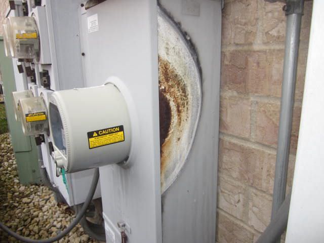

Mike Lamb Posted March 12, 2012 Report Share Posted March 12, 2012 Might this rust have been precipitated by a fire? Click to Enlarge 42.98 KB Quote Link to comment Share on other sites More sharing options...
Marc Posted March 12, 2012 Report Share Posted March 12, 2012 Might this rust have been precipitated by a fire? Click to Enlarge 42.98?KB An arc, big dang metal-vaporizing arc. Marc Quote Link to comment Share on other sites More sharing options...
Mike Lamb Posted March 12, 2012 Author Report Share Posted March 12, 2012 Thanks. Thought so. And it would be safe to assume this has been addressed since the front cover is not scorched? Quote Link to comment Share on other sites More sharing options...
Marc Posted March 12, 2012 Report Share Posted March 12, 2012 I'd just mention that the rust won't stop and it may eventually need replacing. Marc Quote Link to comment Share on other sites More sharing options...
hausdok Posted March 12, 2012 Report Share Posted March 12, 2012 Yep and yep. OT - OF!!! M. Quote Link to comment Share on other sites More sharing options...
Denray Posted March 19, 2012 Report Share Posted March 19, 2012 I was visiting some friends in Park City one 4th of July and at around 11:00am a house on the other side of the narrow valley started celebrating early, I thought. It sounded like fireworks and it looked like fireworks. Within a few hours the 8000sq ft house was completely engulfed in flames. Turns out that the service panel started the whole mess. Quote Link to comment Share on other sites More sharing options...
John Dirks Jr Posted March 20, 2012 Report Share Posted March 20, 2012 Looks like heat burned the paint which exposed the metal to rust. Quote Link to comment Share on other sites More sharing options...
