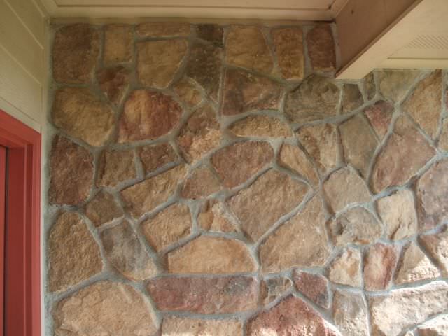

Marc Posted April 29, 2012 Report Share Posted April 29, 2012 Click to Enlarge 54.67 KB There's very little stone veneer in these parts. Can synthetic be discerned from natural just by looking at it? Marc Quote Link to comment Share on other sites More sharing options...
hausdok Posted April 29, 2012 Report Share Posted April 29, 2012 The synthetic usually has a limited number of profiles before you start seeing the same one over. Look at the wall closely enough over large enough a section and you can usually spot the same stone a couple of more times. ONE TEAM - ONE FIGHT!!! Mike Quote Link to comment Share on other sites More sharing options...
Ben H Posted April 29, 2012 Report Share Posted April 29, 2012 How old is the house? I was under the impression that it's pretty much all synthetic used these days. Quote Link to comment Share on other sites More sharing options...
Marc Posted April 29, 2012 Author Report Share Posted April 29, 2012 It's 5 years old Ben. Mike, the photo show about half of the stone installed on this house. I'll be writing up the total lack of weeps and flashing. There's likely only a single contractor that does these installs here and I doubt they read the manufacturer's specs. Good thing I'm a TIJ member. That's the only way I'd know anything about this. This house also had an expansion tank on the water heater. It's the only time I've seen one with my eyes in 9 years. Wait a minute, did someone send Bubba down here??? Marc Quote Link to comment Share on other sites More sharing options...
resqman Posted April 29, 2012 Report Share Posted April 29, 2012 Look along the edges of the "stones" along straight areas like walls and corners. You can often seen where they cut or broke the end off revealing the concrete and aggregate mix. The color is fairly uniform. Seldom will you see a different color streak like the yellow blotch in an orange stone like in the upper left. Quote Link to comment Share on other sites More sharing options...

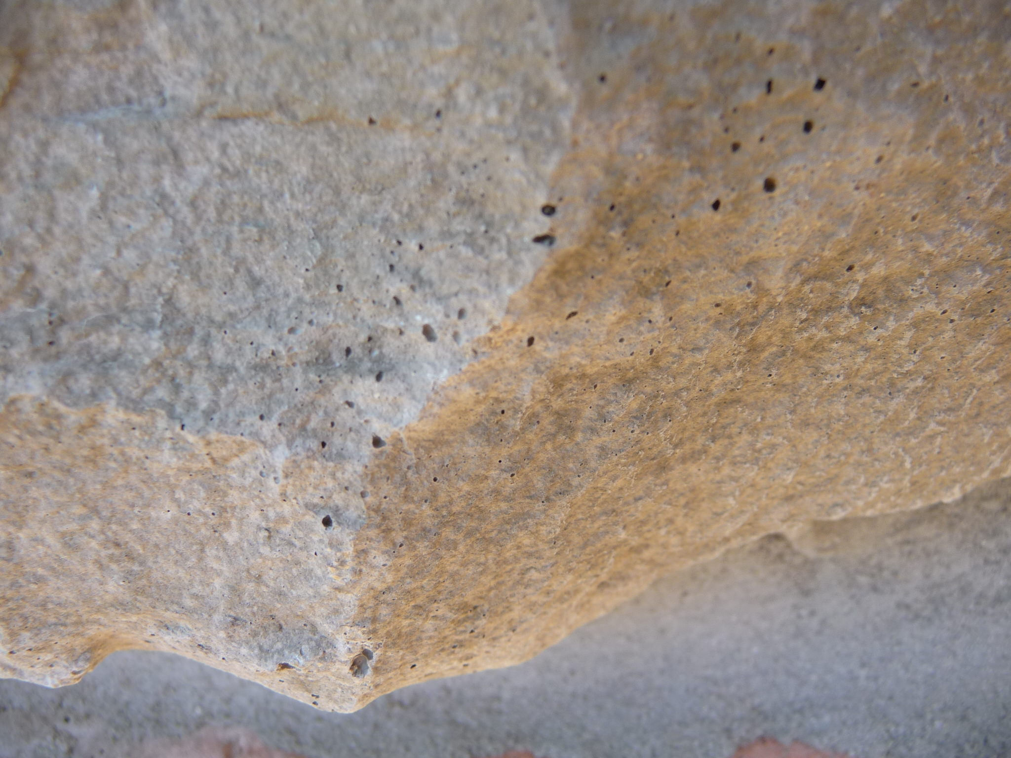

John Dirks Jr Posted April 30, 2012 Report Share Posted April 30, 2012 Click to Enlarge 54.67?KB There's very little stone veneer in these parts. Can synthetic be discerned from natural just by looking at it? Marc Usually you can see small bubbles in the synthetic stones. They come from air bubbles in the mix when it was poured into the mold. Get up real close and use a magnifying glass if you have to. I can catch them with my bare eyes at about 1 foot away. Quote Link to comment Share on other sites More sharing options...

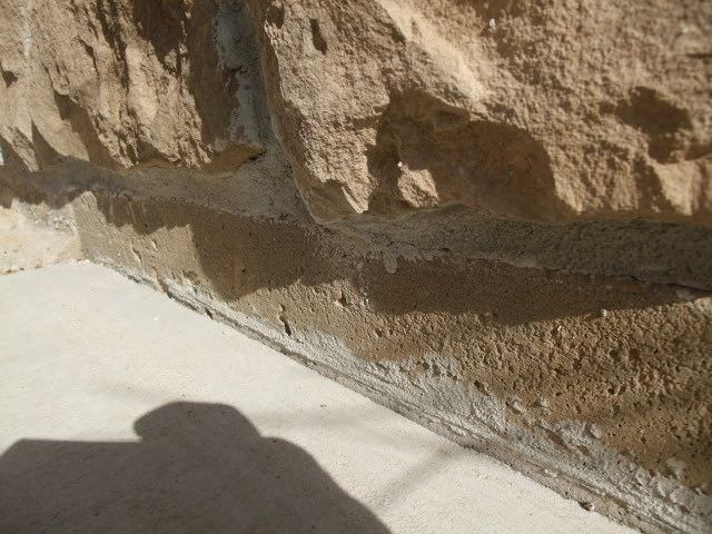

John Kogel Posted April 30, 2012 Report Share Posted April 30, 2012 Faux stone is cheap, real rock is expensive. [] Faux stone seems to float magically in the air, and that is how we like it. Faux stone cracks will appear right through the stone instead of following a mortar line. Click to Enlarge 65.1 KB Click to Enlarge 46.29 KB Click to Enlarge 48.84 KB Quote Link to comment Share on other sites More sharing options...

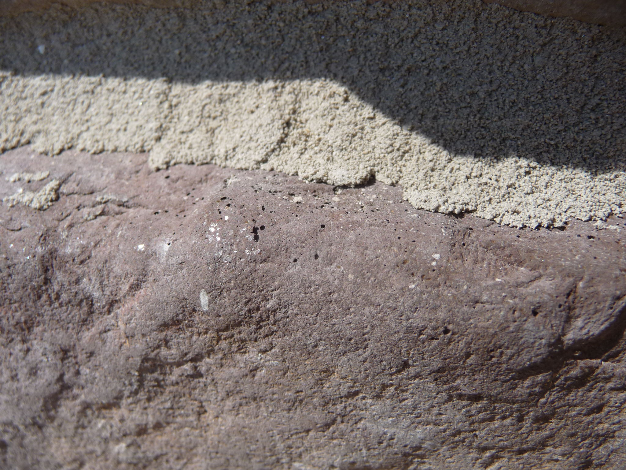

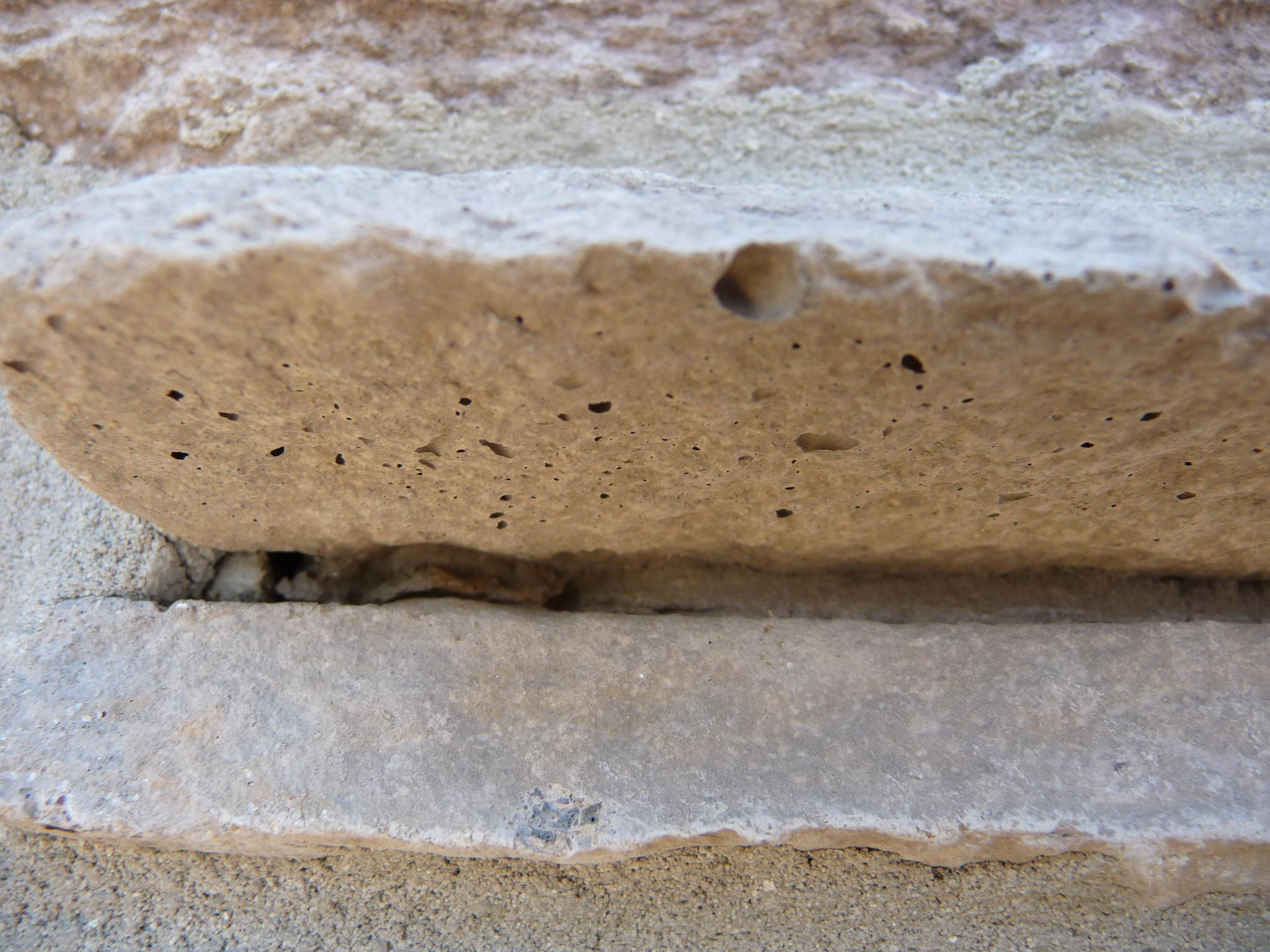

John Dirks Jr Posted May 18, 2012 Report Share Posted May 18, 2012 Here are some close up pics of today's inspection. You can see the bubbles in the manufactured stones. Download Attachment: P1250409.JPG 1654.05 KB Download Attachment: P1250410.JPG 1604.95 KB Download Attachment: P1250411.JPG 1550.64 KB Quote Link to comment Share on other sites More sharing options...
