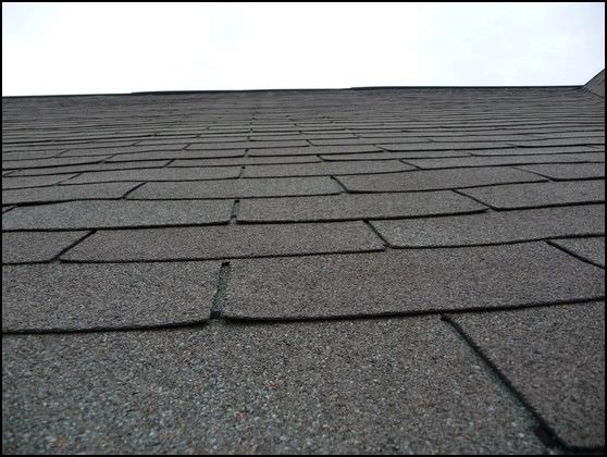

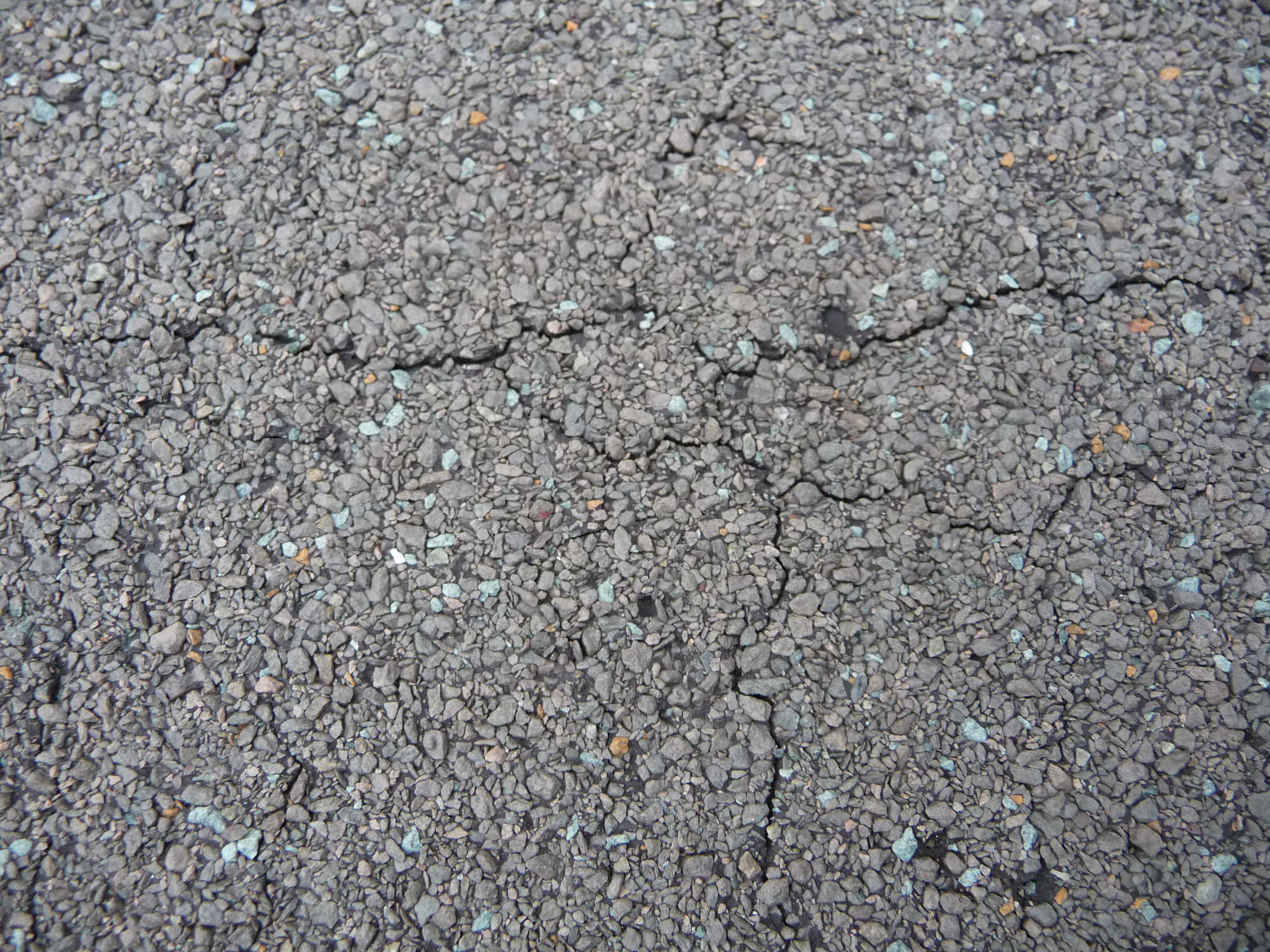

John Dirks Jr Posted October 9, 2012 Report Share Posted October 9, 2012 It's always a good idea to get a close look whenever you can. These shingles are on a 9 year old house. They snapped at the corners like a crisp cracker. Lots of granular erosion too. Whats up with that? Download Attachment: P1300281.JPG 1720.08 KB Download Attachment: P1300295.JPG 1627 KB Quote Link to comment Share on other sites More sharing options...
John Kogel Posted October 9, 2012 Report Share Posted October 9, 2012 No doubt a manufacture's defect. But I would take a close look at the attic ventilation to make sure it can't be blamed on that. Quote Link to comment Share on other sites More sharing options...
kurt Posted October 9, 2012 Report Share Posted October 9, 2012 It's the shingles. Cheap crap or mfg. defect. It isn't lack of ventilation. Quote Link to comment Share on other sites More sharing options...
Tom Raymond Posted October 9, 2012 Report Share Posted October 9, 2012 Just about every 3 tab made in the last 15 years does that, it's how they keep them under $100 a square. Quote Link to comment Share on other sites More sharing options...
inspector57 Posted October 9, 2012 Report Share Posted October 9, 2012 Just about every 3 tab made in the last 15 years does that, it's how they keep them under $100 a square. I see lots of cheap 3 tab shingles around here that do not have that issue. They wear out at around 13-15 years unless hail or wind gets them first but cracking like that does not happen unless it is a manufacturer defect. Lack of ventilation will be blamed but I rarely see shingle problems on HOT, HOT attics with little to no ventilation. Defects seem to be equally distributed among both houses with good and bad ventilation. I'm not saying ventilation has no effect but I think it is more of a cop out for shingle manufacturers than an actual verifiable reason. Quote Link to comment Share on other sites More sharing options...
Rob Amaral Posted October 9, 2012 Report Share Posted October 9, 2012 The claims-guy up here at the roofing manufacturing plant in the next town over calls that 'cracking in the applique' (versus "cracking thru the fiberglass-mat") and says 'it's not a defect that leads to leakage.. ".. Some kind of crazing/shrinkage in the asphalt on the reinforcement .. I guess... Quote Link to comment Share on other sites More sharing options...
kurt Posted October 9, 2012 Report Share Posted October 9, 2012 Yes. It's cracking in the bitumen application, not the mat. I see it all the time, and I've never seen it cause any particular problem. My take is it's the downgrading of the bitumen due to environmental regulations and manufacturer processes to decrease cost. If one has ever seen and smelled an old (like from the early 20th century) coal tar pitch roof system, one knows it's something different from todays materials. I could be wrong on that last bit; it's just my WAG. It's not ventilation because it's well established that vents do nothing to reduce roof covering or attic temperatures. Ventilation is about condensation and moisture issues, re: Joe L. And the whole thing with statistical lifespans........ There's no such thing. Roofing performs as well as it drains. I actually saw a 67 year old roof last Spring; it was on one of those English Cottagey type designs with roof pitches that were about 20:12. There is no reliable data for declaring statistical lifespans. All the statistical lifespan charts one sees are pulled from other charts pulled from other charts ad infinitum....if one followed the path, it would probably end up at the first chart. There is something called a probability distribution, based on analysis of multiple random variables. What we do is based in random variable analysis, although that idea is disputed by most HI's. Most HI's like stat charts. Quote Link to comment Share on other sites More sharing options...

Nolan Kienitz Posted October 9, 2012 Report Share Posted October 9, 2012 Just did a quick look-up in my Haag Engineering guides. Below is their comment for such defects: "Manufacturing Issue: Craze cracks, due to shrinkage and embrittlement of unreinforced asphalt only in the "applique" portion of a shingle. The applique is an extra layer of asphalt and granules added on top of the original layer of asphalt and granules to make a three-tab shingle look like a laminated shingle." Above is a direct quote from their Composition Roofs Damage Assessment Field Guide. Quote Link to comment Share on other sites More sharing options...
