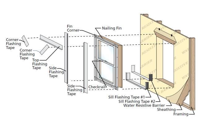

Ben H Posted December 6, 2012 Report Share Posted December 6, 2012 Anyone have a detail image of the proper way to install head flashing? Quote Link to comment Share on other sites More sharing options...

Mike Lamb Posted December 6, 2012 Report Share Posted December 6, 2012 Finned vinyl windows use flashing tape so you won't see the flashing during an inspection. Click to Enlarge 35.4?KB Click to Enlarge 121.23?KB Quote Link to comment Share on other sites More sharing options...
hausdok Posted December 7, 2012 Report Share Posted December 7, 2012 Finned vinyl windows use flashing tape so you won't see the flashing during an inspection. Click to Enlarge 35.4?KB Click to Enlarge 121.23?KB Not necessarily true. Out here, lots of builders use the bituthene around three sides and then use metal head flashings along the top of the window. If they're installing Hardiplank they are required to do so by the manufacturer. ONE TEAM - ONE FIGHT!!! Mike Quote Link to comment Share on other sites More sharing options...
Mike Lamb Posted December 7, 2012 Report Share Posted December 7, 2012 Finned vinyl windows use flashing tape so you won't see the flashing during an inspection. Click to Enlarge 35.4?KB Click to Enlarge 121.23?KB Not necessarily true. Out here, lots of builders use the bituthene around three sides and then use metal head flashings along the top of the window. If they're installing Hardiplank they are required to do so by the manufacturer. ONE TEAM - ONE FIGHT!!! Mike Right. This would be a typical vinyl siding install. Quote Link to comment Share on other sites More sharing options...
Marc Posted December 7, 2012 Report Share Posted December 7, 2012 Finned vinyl windows use flashing tape so you won't see the flashing during an inspection. Click to Enlarge 35.4?KB Click to Enlarge 121.23?KB Drawing shows the side flashing installed over the window flange but I've seen some that show the side flashing installed under the window flange. Chk out the stucco article in the October issue of JLC. By Gene Summy. There doesn't seem to be a clear industry consensus. Marc Quote Link to comment Share on other sites More sharing options...

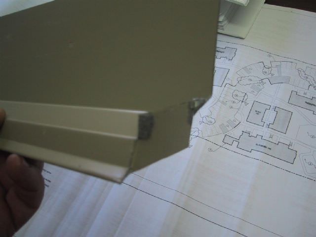

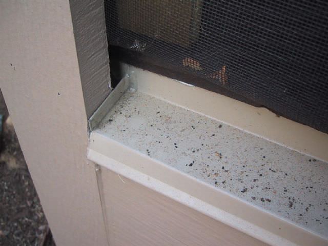

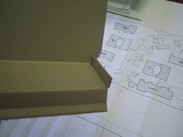

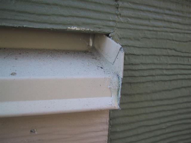

Jim Katen Posted December 8, 2012 Report Share Posted December 8, 2012 Click to Enlarge 34.03?KB I've gotten spoiled and now prefer to see end dams. Click to Enlarge 26.9?KB Click to Enlarge 27.74?KB Click to Enlarge 60.79 KB Click to Enlarge 44.79 KB Click to Enlarge 34 KB Click to Enlarge 26.11 KB Quote Link to comment Share on other sites More sharing options...
Erby Posted December 8, 2012 Report Share Posted December 8, 2012 Dang Jim. You are spoiled! Quote Link to comment Share on other sites More sharing options...
kurt Posted December 8, 2012 Report Share Posted December 8, 2012 Elitist. Quote Link to comment Share on other sites More sharing options...
