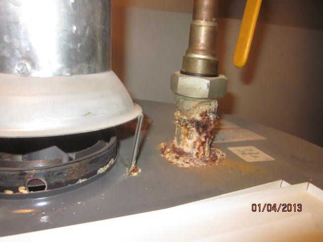

Mike Lamb Posted January 4, 2013 Report Share Posted January 4, 2013 The nipple on this 6 year old cold water inlet is badly rusted but I am more concerned about the female tank inlet fitting. If this is also badly corroded can it be replaced? Is it removable? Click to Enlarge 32.02?KB Quote Link to comment Share on other sites More sharing options...
hausdok Posted January 4, 2013 Report Share Posted January 4, 2013 Yeah, Purchase an identical union. Replace the rusted nipple and use half of the new union to mate to the other half of the old union that is soldered to the pipe and you're done. ONE TEAM - ONE FIGHT!!! Mike Quote Link to comment Share on other sites More sharing options...
Marc Posted January 5, 2013 Report Share Posted January 5, 2013 Seems to me that Mike L was referring to the fitting on the tank itself. It looks badly corroded. I haven't dissected a water heater lately but my guess is that female fitting is welded to the tank. Marc Quote Link to comment Share on other sites More sharing options...
Mike Lamb Posted January 5, 2013 Author Report Share Posted January 5, 2013 Seems to me that Mike L was referring to the fitting on the tank itself. It looks badly corroded. I haven't dissected a water heater lately but my guess is that female fitting is welded to the tank. Marc Right. The last water heater I installed had flush female fittings at the top of the tank. I don't know if these can be removed with an easy-out. Quote Link to comment Share on other sites More sharing options...
kurt Posted January 5, 2013 Report Share Posted January 5, 2013 You might get lucky. How important is it to gamble? That is the location where my old heater failed, and it didn't look bad at all. When it failed, it went big time. Pop, geyser in the basement. Thankfully I was home at the time. You're taking large chances if you don't change out the heater. Quote Link to comment Share on other sites More sharing options...
Mike Lamb Posted January 5, 2013 Author Report Share Posted January 5, 2013 You might get lucky. How important is it to gamble? That is the location where my old heater failed, and it didn't look bad at all. When it failed, it went big time. Pop, geyser in the basement. Thankfully I was home at the time. You're taking large chances if you don't change out the heater. That's why I was wondering about how the manufacturer installs the inlet. Is it fixable or do you replace a 6 yr old 75 gallon tank? I'll see if I can talk to General on Mon. Quote Link to comment Share on other sites More sharing options...
hausdok Posted January 5, 2013 Report Share Posted January 5, 2013 Don't know about ChiTown. Around here a 50 - 60 gallon tank will last about 10 to 15 years if it's properly maintained and a 75 to 80 gallon tank can last nearly twice as long because it goes through fewer heat/cold exchanges. In the abscence of anything indicating a serious problem with the tank, I'd replace that nipple and half of that union for less than $30 in parts before I'd replace a 6-y.o. water heater. ONE TEAM - ONE FIGHT!!! Mike Quote Link to comment Share on other sites More sharing options...
