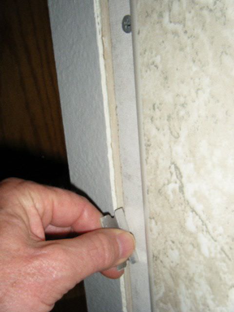

Denray Posted January 16, 2013 Report Share Posted January 16, 2013 So now I have these gaps between the tile and the original drywall occupied by Hardibacker, What is the best way to fill them in to match the drywall? Can I just mud them up with some tape down the drywall seam? Click to Enlarge 39.7 KB Click to Enlarge 38.38 KB Quote Link to comment Share on other sites More sharing options...
John Kogel Posted January 16, 2013 Report Share Posted January 16, 2013 I think that might be the way to go. I don't think it will be easy tho, because the mud will shrink and sag. It will take a lot of layers to fill, and then it might be prone to cracking. But with tape, might work OK. Cutting the backer board flush with the tiles is not going to be easy, but then you could fill the gaps with strips of drywall and only have to mud a seam. Cut the existing drywall corner away, shim out a new drywall strip that goes from the tiles to the corner. That's a messy job, but eliminates that tricky seam. You then would have a corner bead to do. If you can find some of that white hardboard, it might bring those gaps up flush to the existing drywall. I've has decent success taping and plastering drywall to wood transitions on corners of closet openings if the wood is clean. Why didn't you figure this out before you got the tiles up? [] Quote Link to comment Share on other sites More sharing options...

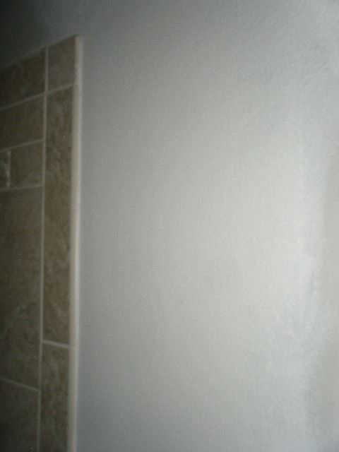

Denray Posted January 16, 2013 Author Report Share Posted January 16, 2013 A drywaller at a recent party I was at said fill the gap with fix all, that powdered stuff in the can you mix with water. I had no pics to show him so he may have not been on the same page with me. Click to Enlarge 37.75 KB Click to Enlarge 45.29 KB Quote Link to comment Share on other sites More sharing options...

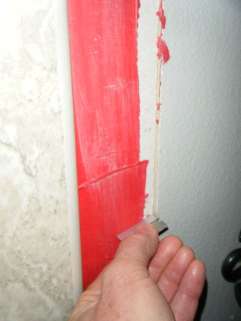

Mike Lamb Posted January 16, 2013 Report Share Posted January 16, 2013 This is how I have done it with Durock with no complaints. Fill the gap with mud and let that dry. Then I tape with a fiberglass mesh. I always use Durabond 20 from the brown bag for my scratch coat. It dries nice and hard. Then I will finish with the softer Durabond. Quote Link to comment Share on other sites More sharing options...
Tom Raymond Posted January 16, 2013 Report Share Posted January 16, 2013 What Lamb said, but use Durabond 90. DURABOND 20 sets in about 20-30 minutes; DURABOND 45 in 30-80 minutes; DURABOND 90 in 85-130 minutes; and DURABOND 210 in 180-240 minutes. The longer open time will give you a time to clean your tools and grab a beer before the finish coat. It's been months, what's another 90 minutes? Quote Link to comment Share on other sites More sharing options...

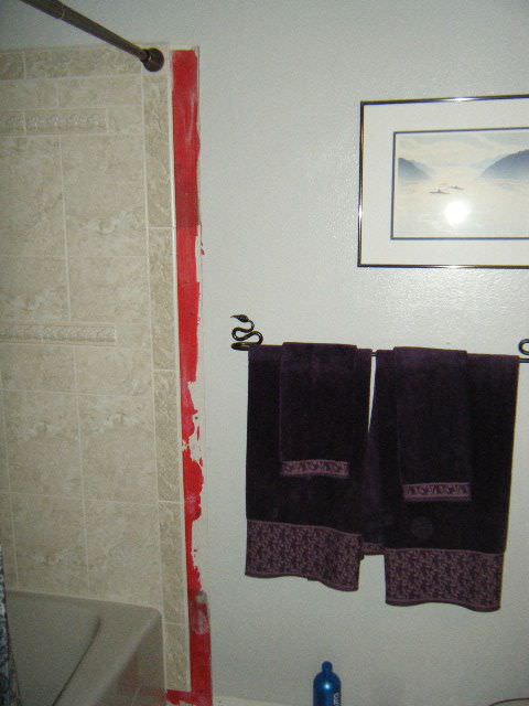

Denray Posted January 17, 2013 Author Report Share Posted January 17, 2013 Will the mud stick to the nearby painted drywall so I can feather it out? Quote Link to comment Share on other sites More sharing options...
kurt Posted January 18, 2013 Report Share Posted January 18, 2013 Durabond Easy Sand can be feathered and wet sanded to blend nicely with whatever you're doing. Quote Link to comment Share on other sites More sharing options...

Denray Posted January 18, 2013 Author Report Share Posted January 18, 2013 I left room for the base molding. Just put up my second coat of mud. What are cut tiles? Quote Link to comment Share on other sites More sharing options...

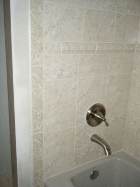

Denray Posted January 18, 2013 Author Report Share Posted January 18, 2013 Ah, but you see now lad, the misses picked all this stuff out. Got to have the bullnose and from the same collection. That goofyass trim stuff up there in two rows was fun to fit and grout. Click to Enlarge 29.55 KB Click to Enlarge 36.81 KB Quote Link to comment Share on other sites More sharing options...

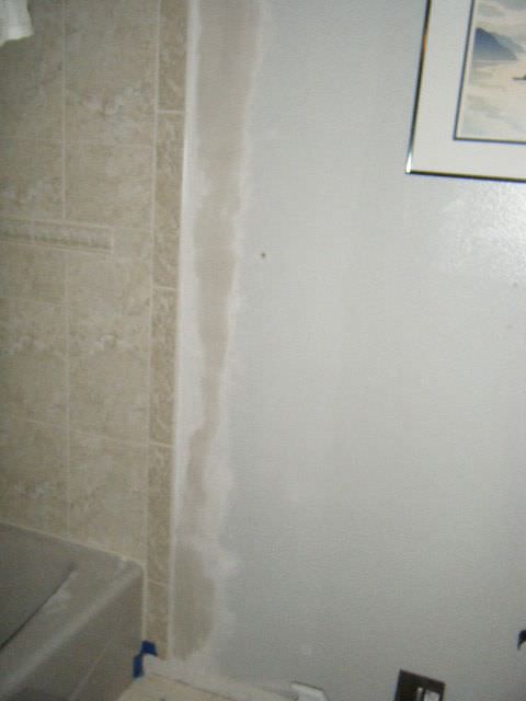

Denray Posted January 21, 2013 Author Report Share Posted January 21, 2013 Turns out that the patch was pretty easy. At least compared to doing the tile thing. Click to Enlarge 24.71 KB Quote Link to comment Share on other sites More sharing options...
