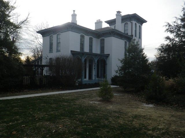

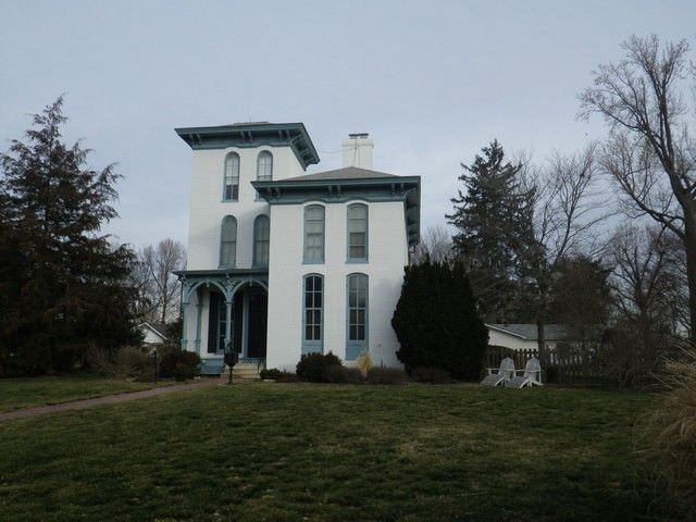

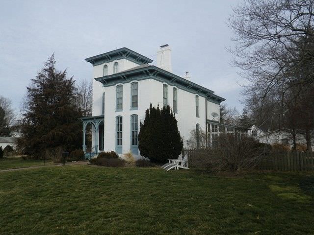

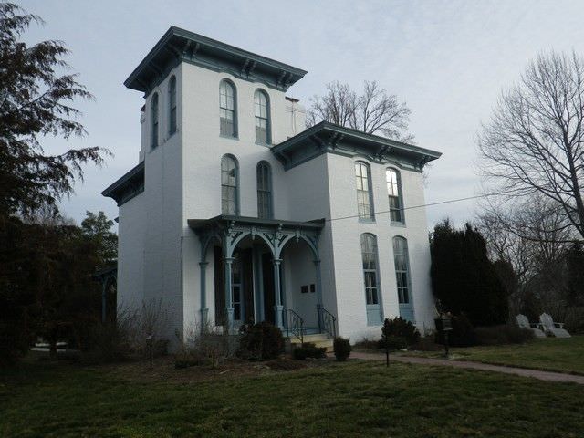

Mark P Posted January 24, 2013 Report Share Posted January 24, 2013 House in Troy, IL built in 1870 and on the National Register of Historic Places. Really cool and enjoyable inspection. The car is 1939 - orginal owner. What is this "style" of home? The gutters are all copper and not visible from the ground they are sort of built into the edge of the roof. Is there a term for this type of guttering system? Download Attachment: 004.jpg 135.92 KB Click to Enlarge 60.74 KB Click to Enlarge 57.65 KB Click to Enlarge 62.92 KB Click to Enlarge 72.87 KB Click to Enlarge 49.3 KB Click to Enlarge 62.88 KB Click to Enlarge 78.28 KB Quote Link to comment Share on other sites More sharing options...
Jerry Simon Posted January 24, 2013 Report Share Posted January 24, 2013 Gothic Hidden gutters Quote Link to comment Share on other sites More sharing options...
Marc Posted January 24, 2013 Report Share Posted January 24, 2013 I call them internal gutters. The ones I've seen are wood, lined with pitch. Marc Quote Link to comment Share on other sites More sharing options...
Bill Kibbel Posted January 24, 2013 Report Share Posted January 24, 2013 Italianate Built-in gutters or box gutters Quote Link to comment Share on other sites More sharing options...

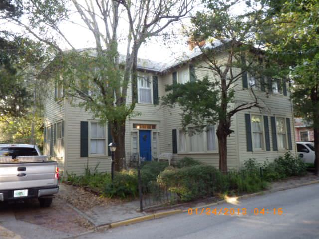

davidlord Posted January 25, 2013 Report Share Posted January 25, 2013 Must be old house day. My afternoon appointment was circa 1889. Click to Enlarge 70.91 KB Quote Link to comment Share on other sites More sharing options...

Mark P Posted January 25, 2013 Author Report Share Posted January 25, 2013 Thanks for the link to the Historic Buildings. I really need to sit down and learn the different architectural styles. Any other sources any one have? Regarding the box gutters, the ones on this house looked to be copper. The seams are just caulked. From the ground I found what looked like water damage to the soffitt at the highest point on the house. No attic in that look-out to see inside. Would it just be a matter of someone sealing (caulking ) the gutter seam at the suspected leak location? Quote Link to comment Share on other sites More sharing options...
Bill Kibbel Posted January 25, 2013 Report Share Posted January 25, 2013 Thanks for the link to the Historic Buildings. I really need to sit down and learn the different architectural styles. Any other sources any one have? Regarding the box gutters, the ones on this house looked to be copper. The seams are just caulked. From the ground I found what looked like water damage to the soffitt at the highest point on the house. No attic in that look-out to see inside. Would it just be a matter of someone sealing (caulking ) the gutter seam at the suspected leak location? Joints on copper need to be soldered. Quote Link to comment Share on other sites More sharing options...
kurt Posted January 25, 2013 Report Share Posted January 25, 2013 Yup. Caulk only hides the problem for a while. You have to be really careful looking @ built in gutters; there can be all sorts of rot in the rafter tails and adjacent eave woodwork that's not visible or detectable until you get right up close and personal to it. It's not uncommon to set the ladder up, climb up the eave, and find someone's done a bondo job on brackets and other decorative elements. We sometimes call them inlaid gutters, but mostly built in. Quote Link to comment Share on other sites More sharing options...
