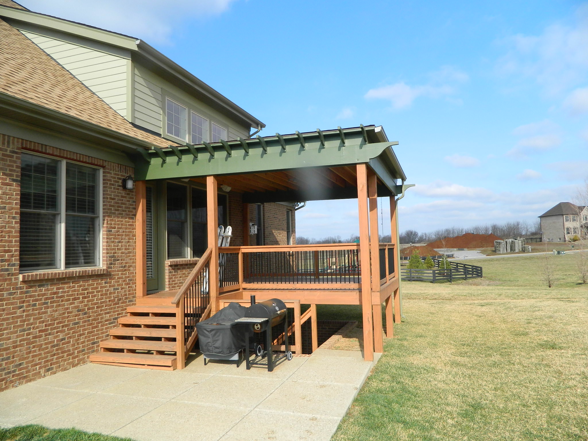

Ben H Posted March 12, 2013 Report Share Posted March 12, 2013 Anyone ever seen one? This was holding up a roof/pergola on a custom home. I was under the impression having them outside was a no-no. The best I can find from iLevel is they make "some" models that can be used outdoors. Download Attachment: DSCN9875.JPG 746.88 KB Download Attachment: DSCN9879.JPG 725.01 KB Quote Link to comment Share on other sites More sharing options...
rkenney Posted March 12, 2013 Report Share Posted March 12, 2013 LVL is available for exterior use and in some situtations even for ground contact use. BUT it depends on your application whether LVL will meet your exterior needs. American Pole & Timber distributes pressure-treated LVL. Quote Link to comment Share on other sites More sharing options...
Bill Kibbel Posted March 12, 2013 Report Share Posted March 12, 2013 ilevel, trus joist & microllam are all Weyerhaeuser brands. I don't think Weyerhaeuser has an LVL for exterior exposure. Their product for outdoors is a preservative treated PSL (parallam). Quote Link to comment Share on other sites More sharing options...
Ben H Posted March 13, 2013 Author Report Share Posted March 13, 2013 I've tried to call them all afternoon and never could get a person. I have to wonder with it being painted, and under the roof, would it actually work with little to no issue's? It's been two years and it still looks new... Quote Link to comment Share on other sites More sharing options...
Rocon Posted March 13, 2013 Report Share Posted March 13, 2013 Section 5.5 http://www.icc-es.org/reports/pdf_files ... R-1387.pdf Quote Link to comment Share on other sites More sharing options...
