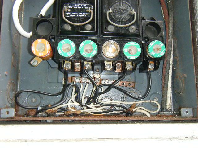

Denray Posted March 13, 2013 Report Share Posted March 13, 2013 Do you think this is providing. 6? Would this be considered old equipment for a 1955 house? Click to Enlarge 74.06 KB Quote Link to comment Share on other sites More sharing options...
John Kogel Posted March 13, 2013 Report Share Posted March 13, 2013 Yep, I see 2 240 volt circuits and 4 120 volt circuits which are drastically overfused. Nope, it would likely be original 50's equipment. I get a kick out of the FPE "No-Ark" brand - What, there's no boat? [] Quote Link to comment Share on other sites More sharing options...
