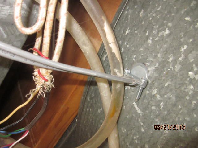

Mike Lamb Posted March 22, 2013 Report Share Posted March 22, 2013 I know this has been discussed before so if someone could direct me to that thread I would appreciate it. My search came up empty. The reason you cannot run Romex through heat ducts is because it cannot be properly secured in place??? 300.11 Click to Enlarge 47.59?KB Quote Link to comment Share on other sites More sharing options...
Mike Lamb Posted March 22, 2013 Author Report Share Posted March 22, 2013 Maybe it hasn't been discussed before. 300.22 Quote Link to comment Share on other sites More sharing options...

Jim Katen Posted March 23, 2013 Report Share Posted March 23, 2013 Maybe it hasn't been discussed before. 300.22 Good video. Quote Link to comment Share on other sites More sharing options...
