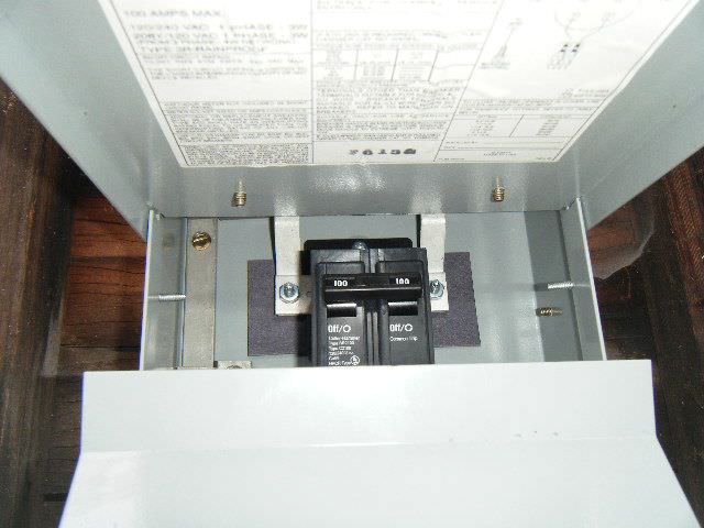

Denray Posted April 2, 2013 Report Share Posted April 2, 2013 I thought how easy it would be to put this deadfront panel too far back. Click to Enlarge 48.52 KB Quote Link to comment Share on other sites More sharing options...
hausdok Posted April 2, 2013 Report Share Posted April 2, 2013 Not unless you cut the notches in the sides deeper. OT - OF!!! M. Quote Link to comment Share on other sites More sharing options...
Neal Lewis Posted April 2, 2013 Report Share Posted April 2, 2013 That's an exterior rated panel box? Thankfully there's very few of those around here. I don't like those inner covers. Quote Link to comment Share on other sites More sharing options...
Denray Posted April 2, 2013 Author Report Share Posted April 2, 2013 Looks like if you don't get it vertical as soon as you clear the lid you could easily contact those fat conductor blades above the main breaker. Installed around 2006. I would have thought that newer equipment wouldn't have that potential. I kind of instinctively pull them out carefully and glad I did.[:-crazy] Quote Link to comment Share on other sites More sharing options...
