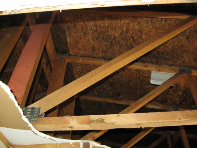

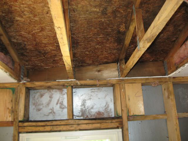

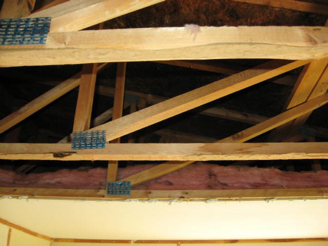

Fredartic Posted April 20, 2013 Report Share Posted April 20, 2013 Hi, we have a second house in NY state. It' a mobile home built in 1983. There is a cathedral ceiling in the dining room and in the family room. The height of the ceiling is 7 ft in its lower point and 10 ft in its higher. I've checked the dept of the space between the ceiling and the roofdeck and it is 7 and half inches. So, I supposed it's 2 x 8 or another design joist. Our energy bills are very expensive. In a winter, not the last cause we winterized it this year, cost $200. a week, without being there, just to protect against frozen! We don't want to add space because we like the ceiling height. So, we expect to remove the actual insulation and 1-) put the Roxul product, 5 and half thick that represent R-24 or 2-) 7 and half thick for R-28 that will let in the first case, 2 inches for the ventilation and in the second case, only a quater of inch for ventilation... Or, 3-) we are wondering if we can put a rigid polystyrene and seal it tight instead of Roxul. Or, 4-) can we mix Roxul and styrofoam? Another question on that ceiling, is that we want to put thin toungue and groove pine. Is there any restriction to do it? I join some pictures of the attic in a bedroom that doesn't have a cathedral ceiling. You can see that there is no vapor barrier and not much insulation that caused ice dam. Also, there are no ventilation, blocked by 2 x 8... So many works to do here, so consider the best solution at best price please. Thank you very much for your precious advice. This is a very nice website! Excuse my english, I'm french canadian. Click to Enlarge 51.45 KB Click to Enlarge 46.4 KB Click to Enlarge 55.56 KB Quote Link to comment Share on other sites More sharing options...

Marc Posted April 20, 2013 Report Share Posted April 20, 2013 Judging from photo #3, it isn't a HUD-Code, which is what most folks are referring to when they say 'mobile home'. Might be a modular but I didn't think they were yet conceived in 83'. Modular would leave Frederic with lots more options than a HUD-Code. Marc Quote Link to comment Share on other sites More sharing options...

Greg Booth Posted April 20, 2013 Report Share Posted April 20, 2013 Judging from photo #3, it isn't a HUD-Code, which is what most folks are referring to when they say 'mobile home'. Might be a modular but I didn't think they were yet conceived in 83'. Modular would leave Frederic with lots more options than a HUD-Code. Marc .............mods were around in the late 60's Quote Link to comment Share on other sites More sharing options...

John Kogel Posted April 21, 2013 Report Share Posted April 21, 2013 Pic 1 shows a double wide or modular home attic, pic 3 looks more like a typical mobile. I wouldn't apply spray foam to OSB unless it was bone dry, fresh from the factory. Certainly not the black spotted sheathing in these pics. JMO. Quote Link to comment Share on other sites More sharing options...
Fredartic Posted April 21, 2013 Author Report Share Posted April 21, 2013 This is a double wide mobile home with an addition. The pictures were not taken in the addition. Quote Link to comment Share on other sites More sharing options...
Fredartic Posted April 21, 2013 Author Report Share Posted April 21, 2013 this is a metal roof that was done maybe 7 years ago Quote Link to comment Share on other sites More sharing options...
kurt Posted April 21, 2013 Report Share Posted April 21, 2013 Pic 1 shows a double wide or modular home attic, pic 3 looks more like a typical mobile. I wouldn't apply spray foam to OSB unless it was bone dry, fresh from the factory. Certainly not the black spotted sheathing in these pics. JMO. Good point. Although, wouldn't a treatment with a microbial make it all OK? Since it's all open, one could tell if it's dry, and a roof leak be readily apparent. Quote Link to comment Share on other sites More sharing options...
