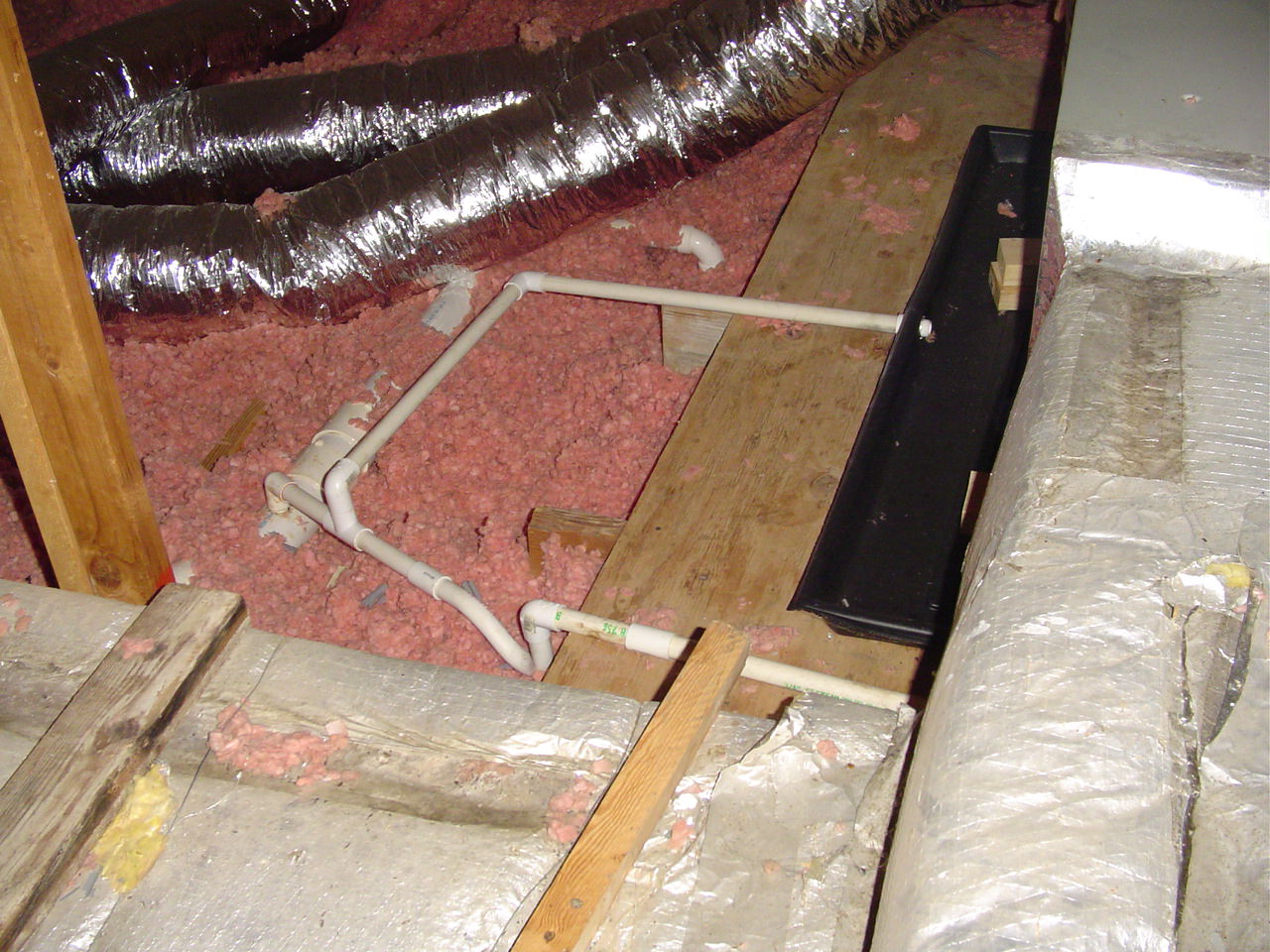

Bain Posted August 16, 2005 Report Share Posted August 16, 2005 So . . . what do you figure's easiest? Cutting a 3/4" hole in a galvanized sewer-vent feeder? Or using a hole saw in the soffit? Brilliant work here, performed by a "licensed professional," who gets to overrule us at times. The overflow-pan drain, seen to the right, terminated perfectly within the garage ceiling. Download Attachment: DSC01495.JPG 616.34 KB Quote Link to comment Share on other sites More sharing options...
hausdok Posted August 16, 2005 Report Share Posted August 16, 2005 Hi Jim, I'll post the picture to the front page, but your behind a few other folk's stuff that's been submitted. In the meantime, I thought the rest of the folks would get a kick out of this. So, lemme see. In KY, folks never heard that there may not be any direct connection of a condensate line to a waste or vent pipe (IRC1411.3/UMC310.1)? If I were you, I'd be posting that photo to the local paper with a short consumer protection article entitled something like When Hiring Local Tradesmen, Ensure They're Competent. The idiot will probably swallow half of his seegar when he sees his own crummy work in the paper. ONE TEAM - ONE FIGHT!!! Mike Quote Link to comment Share on other sites More sharing options...

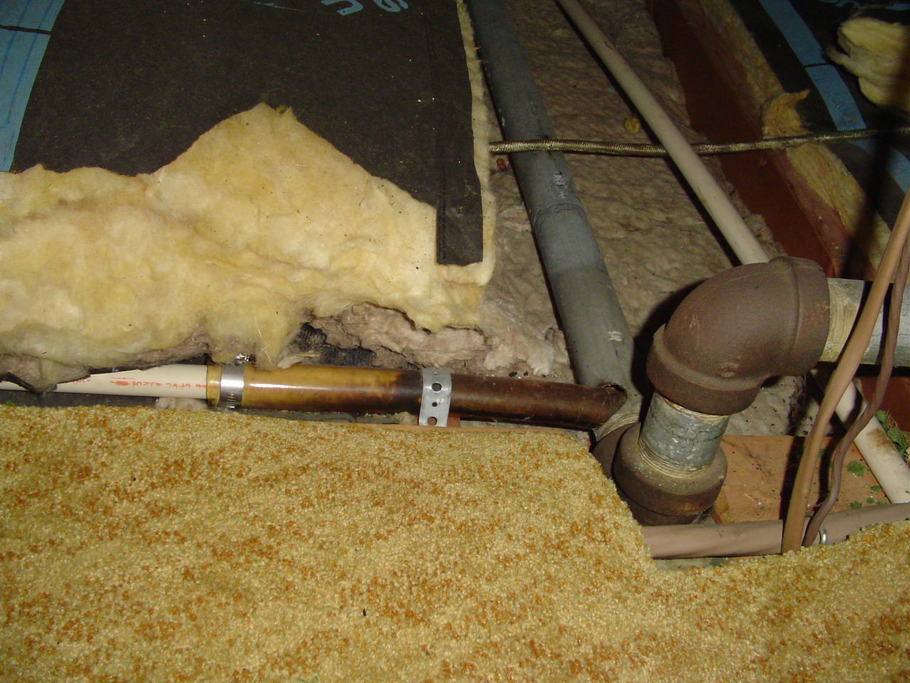

Bain Posted September 1, 2005 Author Report Share Posted September 1, 2005 Again . . . this time in a $750,000.00 house. What are these nuts thinking? Download Attachment: DSC01526.JPG 557.5 KB Quote Link to comment Share on other sites More sharing options...
