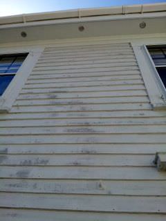

LorLee Posted April 24, 2013 Report Share Posted April 24, 2013 We have a recurring problem, after treatment (JoMax, bleach) and even fresh paint, with a black mildew that shows up on the side of our house every year (some years better/worse than others).Oddly, the sunniest side gets the most... it IS the side that faces a river, about three blocks away. Cleaning it every year is crazy, and almost has us thinking about siding (Hardi Plank maybe?). It's a 3 story house, 1800s, wood... New England. We don't notice it so much on other houses but many of them are vinyl sided. Any suggestions? Is this just something that happens? Thanks! Quote Link to comment Share on other sites More sharing options...
Les Posted April 24, 2013 Report Share Posted April 24, 2013 Hey LorLee, Welcome to the board. It would be quite helpful if you have a photo of the affected area. A "long" establishing shot and a close one. There could be dozens of answers and solutions, so photos are good! Quote Link to comment Share on other sites More sharing options...

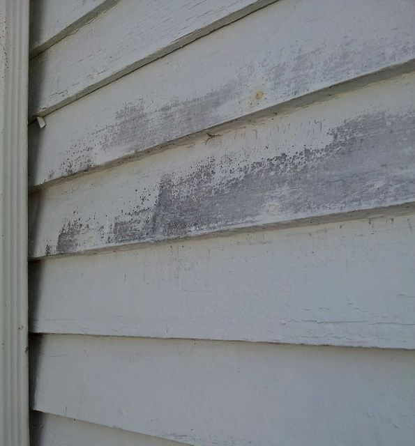

LorLee Posted April 25, 2013 Author Report Share Posted April 25, 2013 Hey LorLee, Welcome to the board. It would be quite helpful if you have a photo of the affected area. A "long" establishing shot and a close one. There could be dozens of answers and solutions, so photos are good! Thank you! Here are two photos, and the close-up photo shows clearly where we stopped cleaning one wall last year... over the winter/early spring, the clapboards we didn't bleach clean got pretty dark in this particular spot. We need to pay somebody to get up high on these ladders and clean... I really don't want my husband doing it year after year. It's driving us crazy. ! (NO mildew or mold issues inside the house.) Thanks for any ideas.... Quote Link to comment Share on other sites More sharing options...

Jerry Simon Posted April 25, 2013 Report Share Posted April 25, 2013 We have a recurring problem, after treatment (JoMax, bleach) and even fresh paint, with a black mildew that shows up on the side of our house every year (some years better/worse than others).Oddly, the sunniest side gets the most... it IS the side that faces a river, about three blocks away. Cleaning it every year is crazy, and almost has us thinking about siding (Hardi Plank maybe?). It's a 3 story house, 1800s, wood... New England. We don't notice it so much on other houses but many of them are vinyl sided. Any suggestions? Is this just something that happens? Thanks! Back in about 1990 or so, the government told paint/stain manufacturers that if they put a mildewcide in their exterior paint or stain, they had to start jumping through a gazillion EPA hoops not present prior to that time. So, the manufacturers simply quit putting the mildewcide in their products. What you're seeing is a result of that. Oddly enough, the paint stores were still allowed to sell packets of mildewcide right next to the new-formula paint/stain; all the customer had to do was pour it in the paint/stain. I suspect that's why you say the staining recurs even after re-painting; no mildewcide in the paint/stain you used. The *mildew* on the house is feeding off organics in the paint/stain; you need to apply a mildewcide. Quote Link to comment Share on other sites More sharing options...
Scottpat Posted April 25, 2013 Report Share Posted April 25, 2013 I think Jerry nailed it. When was the last time you painted the house? Quote Link to comment Share on other sites More sharing options...
LorLee Posted April 26, 2013 Author Report Share Posted April 26, 2013 Wow, thanks! We painted about ... 4-5 years ago. Then noticed the mildew coming back each year, in different places (patches).... the painter INSISTED he put mildewcide in the paint. Maybe he forgot? He was... not the most um... top of the line painter around here, we think. We cleaned last year and the year before, with JoMax ... and the places where it's coming back are both in some of those spots and in new spots. We are in need of paint in some places and thought maybe we'd hire a top notch painter, to scrape all the way down, "treat" the wood (and I have no idea what that means but it sounds good), apply primer and paint with mildewcide mixed in. Is it possible that could take care of the problem? We hate to pay for paint where we only need cleaning, and was thinking of asking the painter if he'd do that, once they're up on scaffold or ladders. ? Quote Link to comment Share on other sites More sharing options...
Les Posted April 26, 2013 Report Share Posted April 26, 2013 LorLee, It is painful, but Jerry and Scott likely are correct! I am a great believer in good paint and good painters. I certainly can't see the entire job from your photos, but what I see looks a little on the skimpy side. The solution now would be; scrape, prime and repaint with the good stuff. I don't know of any magic product. Quote Link to comment Share on other sites More sharing options...
Scottpat Posted April 26, 2013 Report Share Posted April 26, 2013 LorLee, It is painful, but Jerry and Scott likely are correct! I am a great believer in good paint and good painters. I certainly can't see the entire job from your photos, but what I see looks a little on the skimpy side. The solution now would be; scrape, prime and repaint with the good stuff. I don't know of any magic product. Good stuff really cant't be found at Lowes or Home Depot! Sherwin Williams, Ben Moore and Pratt & Lambert make some of the better paints, IMVHO. Quote Link to comment Share on other sites More sharing options...
Les Posted April 26, 2013 Report Share Posted April 26, 2013 LorLee, It is painful, but Jerry and Scott likely are correct! I am a great believer in good paint and good painters. I certainly can't see the entire job from your photos, but what I see looks a little on the skimpy side. The solution now would be; scrape, prime and repaint with the good stuff. I don't know of any magic product. Good stuff really cant't be found at Lowes or Home Depot! Sherwin Williams, Ben Moore and Pratt & Lambert make some of the better paints, IMVHO. Agreed! I like Sherwin-Wms and a local company. Quote Link to comment Share on other sites More sharing options...

John Kogel Posted April 27, 2013 Report Share Posted April 27, 2013 If there is a busy street past the house, it could be soot and carbon from deisel engines. That is my guess, for what it's worth. Quote Link to comment Share on other sites More sharing options...
John Dirks Jr Posted April 27, 2013 Report Share Posted April 27, 2013 I think moisture is saturated in certain parts of those siding boards. If it were simply a lack of mildew resistant paint, wouldn't the patterns be more uniform? Looks like trapped moisture in specific parts of those boards. Quote Link to comment Share on other sites More sharing options...
Tom Raymond Posted April 27, 2013 Report Share Posted April 27, 2013 It very well could be contributing, the prep on the last paint job was lousy from what I can see in the pics. Quote Link to comment Share on other sites More sharing options...
Stephen Lagueux Posted April 27, 2013 Report Share Posted April 27, 2013 I agree with John, condensation inside the wall due to lack or bad insulation and/or vapor barrier. Who knows what these boards are hiding. As you all know, mildew is the product of a combination of many factors. Absence of mildewcide in the paint will not make mildew appear out of the blue. It simply protects the cellulose in the paint film from being eaten away by those micro-organisms. Quote Link to comment Share on other sites More sharing options...
Scottpat Posted April 27, 2013 Report Share Posted April 27, 2013 As you all know, mildew is the product of a combination of many factors. Absence of mildewcide in the paint will not make mildew appear out of the blue. It simply protects the cellulose in the paint film from being eaten away by those micro-organisms. I still think it is a paint issue. The paint is peeling along the edges. Quote Link to comment Share on other sites More sharing options...

LorLee Posted April 30, 2013 Author Report Share Posted April 30, 2013 It's algae. The original posts sez the sunniest side gets it the most - it's not from moisture or condensation. Replacing wood with fiber cement siding won't fix it. The best brand of paint won't fix it. Any suggestions? Is this just something that happens? Thanks!I've got it on the southwest facing sides of my home, that happen to be facing a large pond. Spray sodium hypochlorite to kill it and scrub with TSP to clean it but, it will come back again. Is your black in color? Interesting we both face bodies of water ... Quote Link to comment Share on other sites More sharing options...

Bill Kibbel Posted May 1, 2013 Report Share Posted May 1, 2013 It's algae. The original posts sez the sunniest side gets it the most - it's not from moisture or condensation. Replacing wood with fiber cement siding won't fix it. The best brand of paint won't fix it. Any suggestions? Is this just something that happens? Thanks!I've got it on the southwest facing sides of my home, that happen to be facing a large pond. Spray sodium hypochlorite to kill it and scrub with TSP to clean it but, it will come back again. Is your black in color? Interesting we both face bodies of water ... Yes, it's black. We've also got 2 shades of green in other areas on unpainted wood. Quote Link to comment Share on other sites More sharing options...
Bill Kibbel Posted May 1, 2013 Report Share Posted May 1, 2013 Do you think that's it? Are you saying that if there is no insulation, this kind of mildew is common? No, there's absolutely no correlation between the algae growth and the lack of insulation. Quote Link to comment Share on other sites More sharing options...
