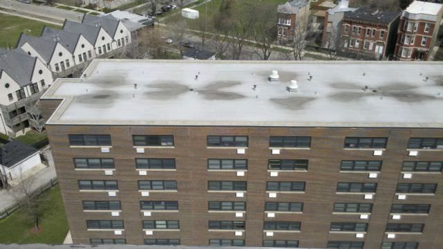

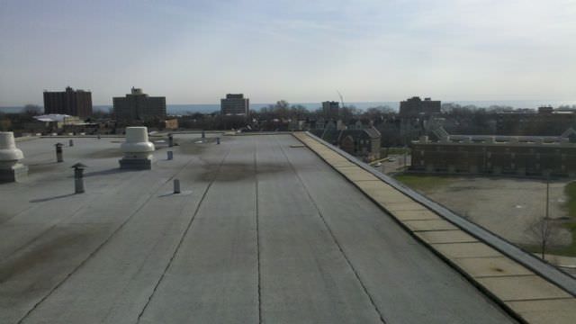

hoosier inspector Posted April 27, 2013 Report Share Posted April 27, 2013 Why would someone go to the trouble of lining the entire rooftop perimeter (except for the penthouse) with 2x2 pavers? They were laid on top of the asphalt cover and not attached or fastened in any way. These pre-dated all building staff and they did not know. Click to Enlarge 25.18 KB Click to Enlarge 46.07 KB Quote Link to comment Share on other sites More sharing options...
kurt Posted April 27, 2013 Report Share Posted April 27, 2013 A misbegotten edge ballast...(?) More than a few flat roofs have blown off, and "edge scrubbing" is a fairly common phenomenon; maybe someone thought it would help. Depending on the age, material, and process, some of the earlier single ply membranes had issues with staying connected to the building. Quote Link to comment Share on other sites More sharing options...
