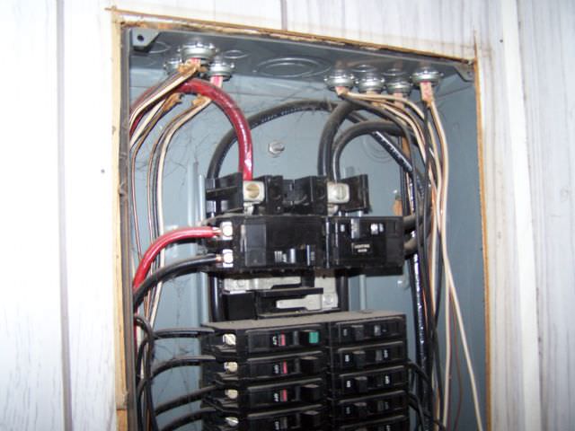

Yooper Posted May 1, 2013 Report Share Posted May 1, 2013 Is this a split bus panel setup with no main shut off? Click to Enlarge 50.16 KB Click to Enlarge 72.18 KB Quote Link to comment Share on other sites More sharing options...
Marc Posted May 1, 2013 Report Share Posted May 1, 2013 Looks like. It doesn't need a main brkr since only two handles removes all power. Main is needed only if it takes more than 6 movements of the hand to remove all power. Marc Quote Link to comment Share on other sites More sharing options...

Jim Port Posted May 1, 2013 Report Share Posted May 1, 2013 There should have been a panel diagram on the label inside the panel showing the bus arrangements. Quote Link to comment Share on other sites More sharing options...
Speedy Petey Posted May 2, 2013 Report Share Posted May 2, 2013 Is this a split bus panel setup with no main shut off? That is a split buss panel with four main breakers. Two of which are in place. Quote Link to comment Share on other sites More sharing options...
Marc Posted May 2, 2013 Report Share Posted May 2, 2013 Is this a split bus panel setup with no main shut off? That is a split buss panel with four main breakers. Two of which are in place. An empty location does not make a main breaker, don't you think? Marc Quote Link to comment Share on other sites More sharing options...
Speedy Petey Posted May 2, 2013 Report Share Posted May 2, 2013 Originally posted by Yooper Is this a split bus panel setup with no main shut off? That is a split buss panel with four POTENTIAL main breakers. Two of which are in place. Quote Link to comment Share on other sites More sharing options...
