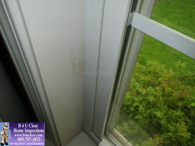

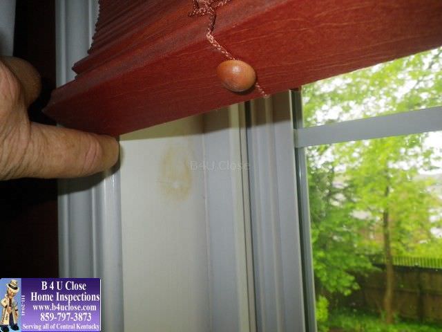

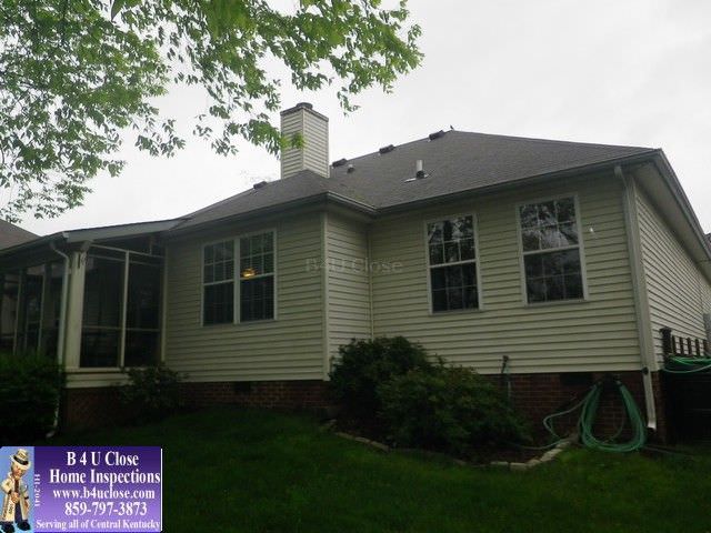

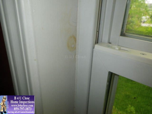

Erby Posted May 13, 2013 Report Share Posted May 13, 2013 15 year old, vinyl sided house. Moisture meter said everything was dry including the drywall under the windows. No visible leak sources around the outside of the windows. Stains were present on both west and east facing windows. Any ideas. Click to Enlarge 62.57 KB Click to Enlarge 47.26 KB Click to Enlarge 32.97 KB Click to Enlarge 44.94 KB Click to Enlarge 50 KB Quote Link to comment Share on other sites More sharing options...
Stephen Lagueux Posted May 13, 2013 Report Share Posted May 13, 2013 No adequate primer sealer on wood? Quote Link to comment Share on other sites More sharing options...
Tom Raymond Posted May 13, 2013 Report Share Posted May 13, 2013 That looks like cheap common lumber to me. Knots and pitch pockets in white pine will bleed for decades. Quote Link to comment Share on other sites More sharing options...
kurt Posted May 14, 2013 Report Share Posted May 14, 2013 Exactly what Raymond said. Shoulda sealed it with shellac before they painted. Quote Link to comment Share on other sites More sharing options...
