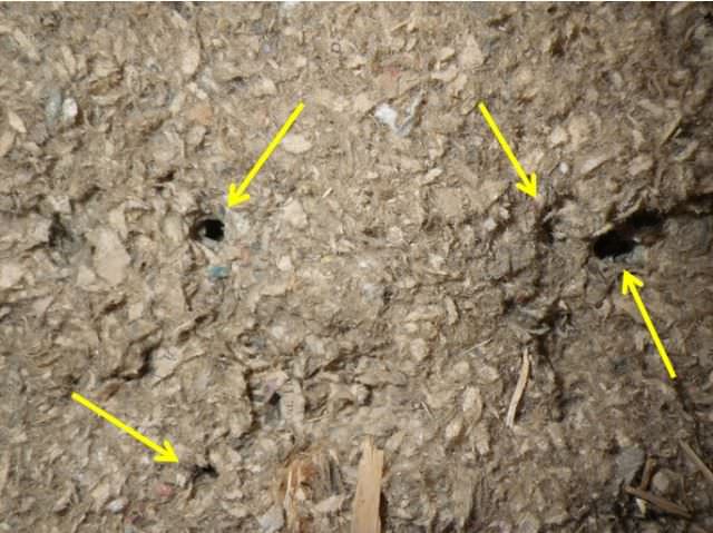

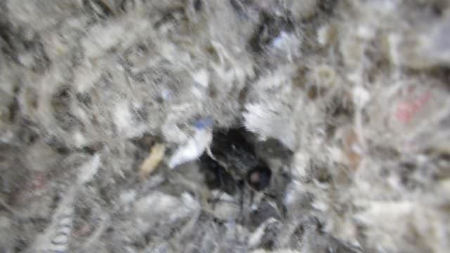

Stephen Lagueux Posted May 23, 2013 Report Share Posted May 23, 2013 Cellulose insulation. Found many pencil size holes and lots of dead flies. Ever heard of flies digging their way through insulation? Click to Enlarge 77.7 KB Click to Enlarge 35.45 KB Quote Link to comment Share on other sites More sharing options...
Jim Katen Posted May 23, 2013 Report Share Posted May 23, 2013 Cellulose insulation. Found many pencil size holes and lots of dead flies. Ever heard of flies digging their way through insulation? Click to Enlarge 77.7 KB Click to Enlarge 35.45 KB Those are cluster flies. They're very common and quite harmless - aside from their great numbers. The usually gather themselves together in bunches, but sometimes, they burrow into insulation to pass through cold spells. Quote Link to comment Share on other sites More sharing options...

Stephen Lagueux Posted May 24, 2013 Author Report Share Posted May 24, 2013 Heard from an exterminator that in some part of the country, some houses can be infested by those flies during the winter months . He once removed houndreds of them from can lights. Quote Link to comment Share on other sites More sharing options...
Greg Booth Posted May 24, 2013 Report Share Posted May 24, 2013 .............in the 70's I owned a country home with balloon framing. The old couple that originally owned the place, swept the attic floor clean of dead cluster flies into the wall cavities. When I stripped plaster from the main floor, the exterior walls were 3 feet deep with dead flies. I still remember the smell......Greg Quote Link to comment Share on other sites More sharing options...
