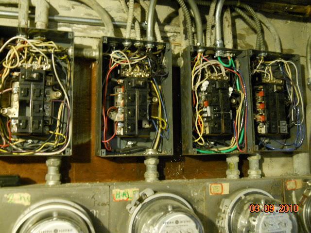

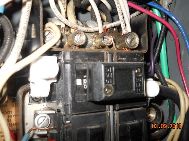

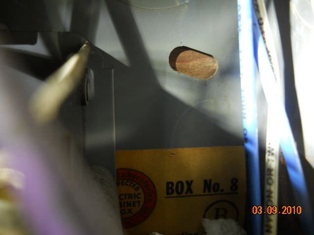

Mike Lamb Posted June 1, 2013 Report Share Posted June 1, 2013 All of these old Pushmatic panels had 50 amp main disconnects except for one which was upped to 100 amps. I am assuming that exceeds the intended panel capacity but I could not see the label to verify this. Any help? Click to Enlarge 82.91 KB Click to Enlarge 62.71 KB Click to Enlarge 30.22 KB Quote Link to comment Share on other sites More sharing options...
Jim Katen Posted June 1, 2013 Report Share Posted June 1, 2013 I think your conclusion is valid. Did the panel with the 100-amp main breaker have larger service conductors? Quote Link to comment Share on other sites More sharing options...
kurt Posted June 1, 2013 Report Share Posted June 1, 2013 The setup you're seeing is pretty common in 4-12 unit apartment buildings. Regardless of listing, most of these are tapped out, there's usually new appliances and devices not counted in the original configuration, and the room air conditioners usually found in the apartments aren't on dedicated circuits. Not to mention the tangle of AC/BX that's coming out of the top of the panels; can't run that stuff in lengths >6' in the city. It's real easy to can these arrangements on multiple counts. The (too small) panels are only part of the problem. Most often, the building service is only 200 amps. Quote Link to comment Share on other sites More sharing options...
Mike Lamb Posted June 1, 2013 Author Report Share Posted June 1, 2013 Lots of double taps, underwired breakers. The building has a central boiler with multiple window AC units to all flats. The conductors for the 100 amp upgrade were OK size wise. Quote Link to comment Share on other sites More sharing options...
Eric B Posted June 4, 2013 Report Share Posted June 4, 2013 I am assuming that exceeds the intended panel capacity but I could not see the label to verify this. Personally, I wouldn't take the assumption route - primarily because I like to avoid being wrong. I think a better approach is to raise a question on the panel rating and then let someone else pursue it. That way your chances of making an error are pretty slim. Quote Link to comment Share on other sites More sharing options...
