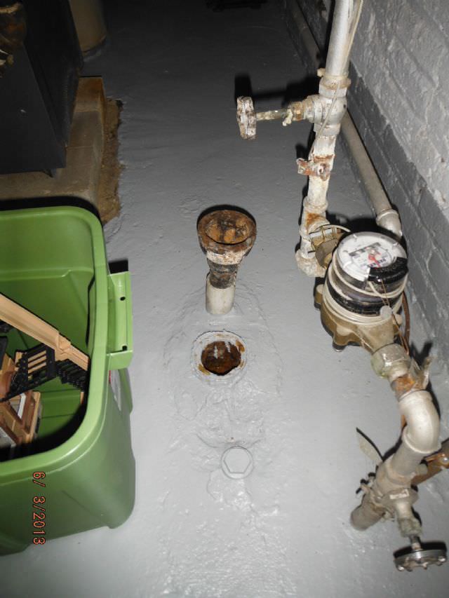

Mike Lamb Posted June 4, 2013 Report Share Posted June 4, 2013 I did not know what these pipes sticking out of the floor were for but now I am thinking buried oil tank? Click to Enlarge 71.68 KB Quote Link to comment Share on other sites More sharing options...
allseason Posted June 5, 2013 Report Share Posted June 5, 2013 Looks to close to the foundation for a 550g. Chicago guys will know that area better but around here the underground tanks are almost always under the sidewalk in front of their multi unit buildings. Jersey City, Hoboken, Newark, etc. Quote Link to comment Share on other sites More sharing options...
kurt Posted June 5, 2013 Report Share Posted June 5, 2013 No, not a tank, looks like an old toilet flange....(?) and the vent? Quote Link to comment Share on other sites More sharing options...
Bill Kibbel Posted June 5, 2013 Report Share Posted June 5, 2013 If that funnel is cast iron, I've seen them on indirect inlets. Used for icebox melt drains, boiler drains and grease interceptors. I see evidence of in-ground tanks 1-2 times each week. Never below basements. Quote Link to comment Share on other sites More sharing options...
kurt Posted June 5, 2013 Report Share Posted June 5, 2013 Never below basements. Same here. Never seen one below a basement floor. Ever. A gas tank under a garage floor once. Since it's right next to the water service, is it the old tile access "buffalo box", for the old water shut off? Quote Link to comment Share on other sites More sharing options...
