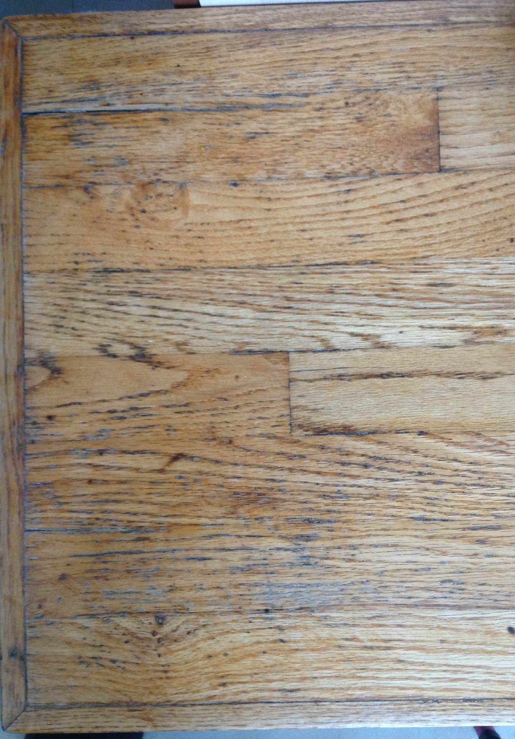

Curiouscrave Posted June 4, 2013 Report Share Posted June 4, 2013 Hello, I'm new to this forum. I'm here in hopes of finding some expert advice on the condition of older furniture in regards to mold and mycotoxins. About ten months ago I inherited some furniture. I have 3 tables from the 1940's my grandfather built, an old cedar chest, a wood display case, and two wooden/upholstered chairs. When I received them they were in bad condition. I refinished all of them (cleaning, sanding, staining, sealing). I also steam cleaned and sun dried the two chairs wood/upholstered. The past couple months I've been fighting some illness and my doctor believes I am being exposed to mold somehow. My house is brand new, built just ten months ago and I am pretty positive there is no mold there as i have done several mold tests. As I was evaluating everything I started to wonder if the old furniture was the problem. I know all the furniture was stored for many many years in a basement that had flooded. Even though I don't see anything furry or fuzzy growing maybe there are dead mold spores or mycotoxins coming from the furniture. There is some discoloration in certain areas of the wood but my husband says that is were the wood has aged. I am open to any opinions or knowledge anyone has on dealing with this issue. I would hate to have together rid of the furniture but should I get rid of it? Thanks so much. Download Attachment: image.jpg 1268.73 KB Quote Link to comment Share on other sites More sharing options...
Jim Katen Posted June 5, 2013 Report Share Posted June 5, 2013 I suggest that you take all of the suspect furniture and place it in a climate controlled storage unit. Then see what happens to your symptoms. If they go away, introduce one piece of furniture at a time back into the house. Then see what happens to your symptoms. In this way you should be able to identify the offending object or objects. Quote Link to comment Share on other sites More sharing options...
Stephen Lagueux Posted June 5, 2013 Report Share Posted June 5, 2013 What Jim said. What kind of flooding was it? If the basement was clean and got flooded because of a broken pipe, you can salvage the furniture. On the other hand, if the flooding came from surface water from outside the house, porous material such as wood furniture and especially upholstered furniture should have been discarded. If the furniture was not affected by water but was only exposed to aerosolized spores, you could get rid of it by hepa vaccuming it and thorough cleaning. In that case, I'd suggest to talk to an IICRC cleaning specialist. Quote Link to comment Share on other sites More sharing options...

Jim Katen Posted June 5, 2013 Report Share Posted June 5, 2013 I suggest that you take all of the suspect furniture and place it in a climate controlled storage unit. Then see what happens to your symptoms. If they go away, introduce one piece of furniture at a time back into the house. Then see what happens to your symptoms. In this way you should be able to identify the offending object or objects. Thank you for your thoughts I think that is a great idea! That is what I am going to do. So hard to understand how wood works and how mold or mycotoxins live on it. I'm uneducated on the topic and have no experience with this kind of stuff. For the record, I don't believe that mold or mycotoxins have squat to do with your problem. But there are other things that could be going on. Simple trouble shooting is one way to narrow down the search for the problem - if there really is an environmental cause to your problems. Quote Link to comment Share on other sites More sharing options...
