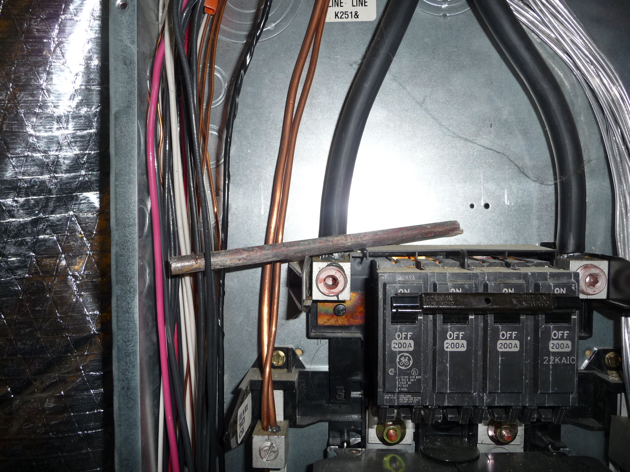

John Dirks Jr Posted June 6, 2013 Report Share Posted June 6, 2013 From now on I'm going to sweep the top of the panel for loose objects before removing the panel cover. I don't remember being told I should be doing it but I sure as heck will be now. As I removed screws and the gap at the top of the panel opened I heard a ca chink sound. Sure enough, a metal rod that was on the top of the panel enclosure fell in. It was a close call. I flung it out of there with a piece of quarter round trim. Download Attachment: P1360726.JPG 1593.73 KB Quote Link to comment Share on other sites More sharing options...
Inspectorjoe Posted June 6, 2013 Report Share Posted June 6, 2013 A close call? That's an understatement! I would have been shittin' bricks. I just added a new procedure to my panel inspection routine. Quote Link to comment Share on other sites More sharing options...
John Dirks Jr Posted June 6, 2013 Author Report Share Posted June 6, 2013 A close call? That's an understatement! I would have been shittin' bricks. I just added a new procedure to my panel inspection routine. Well, the second I heard the ca chink, I became very concerned. At that point, both my hands were on the panel. I slowly pulled it away from the enclosure. I guess it wasn't my day for fireworks. If the insulation on the SEC conductor would have been stripped a bit farther, things would have lit up. However, if you look at the design of the insulation guards, you can see how they performed as designed and prevented the short. Quote Link to comment Share on other sites More sharing options...
John Dirks Jr Posted June 6, 2013 Author Report Share Posted June 6, 2013 BTW, the right end of the metal rod was touching the unpainted interior surface of the panel. Really close call! Almost looks like an intended boobie trap. The rod is the perfect length to provide a jumper between the two hot lugs. Quote Link to comment Share on other sites More sharing options...

rjbrown2 Posted June 7, 2013 Report Share Posted June 7, 2013 Maybe belt and suspenders, but how about test the panel to ground for ~V and wear heavy rubber gloves while removing and replacing the panel cover? Quote Link to comment Share on other sites More sharing options...

gtblum Posted June 7, 2013 Report Share Posted June 7, 2013 I have a friend who had an up close and personal experience with one last year. He's lucky to be around to talk about it. Spent two months in a burn unit. He'll never be the same. I want to know what John did next? You didn't just close the panel back up, right? You didn't just walk away and leave it like that before someone took action, right? Quote Link to comment Share on other sites More sharing options...
asihi Posted June 7, 2013 Report Share Posted June 7, 2013 I want to know what John did next? You didn't just close the panel back up, right? You didn't just walk away and leave it like that before someone took action, right? From his first post "I flung it out of there with a piece of quarter round trim." Quote Link to comment Share on other sites More sharing options...
Marc Posted June 7, 2013 Report Share Posted June 7, 2013 480. I was starting out at the time and it scared me into wearing a cotton over shirt, gloves and face shield while working on hot circuits. Great learning experience, and looked kinda cool. No one got hurt so it was ok. Years ago, I was an electrician in a plant making forged pipe fittings. We had a motor-generator that ran on 480V 3 phase with about a 300 amp fuse, 1,000 amp feeder breaker. Very heavy rotor, took nearly a minute to come up to speed. A starter transformer kicks in first for 20 seconds or so before full voltage is applied to the motor. One day, the controls went wrong and applied full voltage right from the start. This was before I regained my hearing. I felt it in the slab beneath my feet, 2 or 300 hundred feet away in an office. The two steel doors to the 5' wide by 6' tall starter cabinet were blown off and the electric utility called within the minute. It had shown up on their monitors. Marc Quote Link to comment Share on other sites More sharing options...
gtblum Posted June 7, 2013 Report Share Posted June 7, 2013 I want to know what John did next? You didn't just close the panel back up, right? You didn't just walk away and leave it like that before someone took action, right? From his first post "I flung it out of there with a piece of quarter round trim." Sorry, didn't see that. HE DID WHAT?!!!!!! Quote Link to comment Share on other sites More sharing options...
John Dirks Jr Posted June 7, 2013 Author Report Share Posted June 7, 2013 I want to know what John did next? You didn't just close the panel back up, right? You didn't just walk away and leave it like that before someone took action, right? From his first post "I flung it out of there with a piece of quarter round trim." Sorry, didn't see that. HE DID WHAT?!!!!!! In hindsight there was something I should have done but failed to. I should have asked the client to leave the area before clearing the object. I didn't waste much time with it. I looked at it for about 10 seconds and figured an upward and slightly outward flip would work. Fortunately, it did. Quote Link to comment Share on other sites More sharing options...
gtblum Posted June 7, 2013 Report Share Posted June 7, 2013 In hindsight there was something I should have done but failed to. Yes. Stop what you were doing and get an electrician! Man, you got lucky the first time. What if? Quote Link to comment Share on other sites More sharing options...
Marc Posted June 7, 2013 Report Share Posted June 7, 2013 Man, you got lucky the first time. What if? Probably would have vaporized considerable metal from the enclosure, rod, lug and conductor. That utility fuse is big and it's a super-lag. John could have been blinded, at least temporarily. Marc Quote Link to comment Share on other sites More sharing options...
John Dirks Jr Posted June 7, 2013 Author Report Share Posted June 7, 2013 In hindsight there was something I should have done but failed to. Yes. Stop what you were doing and get an electrician! Man, you got lucky the first time. What if? I keep my angels busy. Quote Link to comment Share on other sites More sharing options...

Rob Amaral Posted June 8, 2013 Report Share Posted June 8, 2013 Good broadcast to the forum .. !! We really should wear protective glasses when we remove covers.. this is a classic reason.. Quote Link to comment Share on other sites More sharing options...
Jim Katen Posted June 8, 2013 Report Share Posted June 8, 2013 I've been amusing myself by watching the Slo Mo Guys on Youtube, in which Gav & Dave shoot the world around them with super high speed cameras. The videos are fun and fascinating, but one of the most interesting things they demonstrate is how slowly the human body reacts to stuff that's happening around it. I think that a lot of us figure that if something goes wrong in an electrical panel, we could raise our arms, close our eyes, or otherwise protect ourselves. After watching these videos, you realize that we really just sit there like the faces on Mt. Rushmore while the event unfolds. We don't even realize that anything has happened until it's over. Check out the videos and then go buy some really cool-looking safety glasses. (You're more likely to use them if they look cool. . . ) Quote Link to comment Share on other sites More sharing options...
