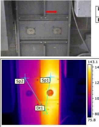

Douglas Hansen Posted June 13, 2013 Report Share Posted June 13, 2013 For the last couple of decades, bus ducts typically have breakaway bolt heads, where the second bolt head snaps off at the proper torque. The only failures I have seen were instances where a connecting section wasn't fully seated prior to torquing the bolts. Quote Link to comment Share on other sites More sharing options...
MPdesign Posted June 13, 2013 Author Report Share Posted June 13, 2013 Click to Enlarge 17.51 KB The problem does appear to be at the splice plate - in several locations - on the same side. Perhaps that side had tension on it during installation causing poor seating? What do you think Douglas? Quote Link to comment Share on other sites More sharing options...
