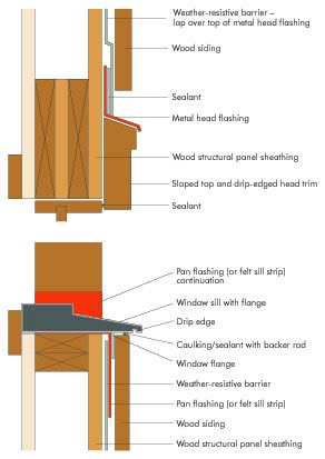

hausdok Posted June 19, 2013 Report Share Posted June 19, 2013 Hi, If it's a wood casement window installed before the advent of aluminum or vinyl window with the nailing flanges that most idiots think are widow flashings, it's probably splined on all sides with heavy asphalt felt splines and should have a metal head flashing above the window. If you're lucky, they put a pan flashing below the sill. If the sill is cracked or the joints where the sill and casing sides meet are un-caulked and dried and separated, water might be getting in that way. If there is a pan flashing beneath the casing it could be leaking. Perform a pick test on the wood window casing and the jacks and rough opening and framing below the window. Replace - do not sister - any wood that the pick test indicates have incipient rot or worse. Don't leave any rotting wood there or you'll be sorry later. If the sloped sill is rotted out, do not replace it with a 2 by 6 laying flat on its side. Find some milled sill material with a drip kerf at a wood supplier someplace. If there are flashings incorporated into the wall plane under that sill and they are rusted out, replace them. Click to Enlarge 31.14 KB Click to Enlarge 19.32 KB Quote Link to comment Share on other sites More sharing options...

Marc Posted June 19, 2013 Report Share Posted June 19, 2013 Also, is that white external trim purely decorative or is it there to protect the window from water? For example, can I take it off, fix the window, and leave it off until the window is ultimately replaced? Or do I need to add it back? It looks like j-channel, a vinyl product that supposed to do the job of flashing as well as exterior window trim. I think you've found your leak. Vinyl cladding lets a lot of water get past it, so much that it's good practice to assume it will happen. You should avoid depending on it to keep water from getting inside the wall cavity where it can do damage like in your pictures. Marc Quote Link to comment Share on other sites More sharing options...
Tom Raymond Posted June 19, 2013 Report Share Posted June 19, 2013 That's a Pella. The sash is rotten. You can see it is no longer square and drags on the bottom. Given the crappy caulk job on the interior I bet it's been that way for a while. The good news is that because it's an operating window you can replace the sash. The bad news is that you have single pane glass with an interior storm panel in NY. That inefficient assembly will have copious amounts of condensation between the panes of glass and the replacement will rot out too. Expect to spend around $300 for a new sash, and another couple hundred for the paint and plaster. I wouldn't open anything up unless other windows exhibit similar damage-that would indicate jacked up flashing details. Be warned that siding cannot be removed mid-wall without damage and must be removed from the top down then reinstalled. That's a lot of siding to take down for flashing repairs (read as 'this is going to be expensive'). Marc, Vinyl siding is a rain screen. Up to 20% of the water that hits it will end up behind it. None of the vinyl accessories in those pics is supposed to function as flashing. The silicone caulk schmutz isn't helping anything either. Quote Link to comment Share on other sites More sharing options...
