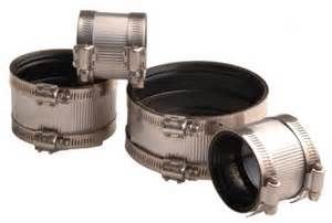

plummen Posted September 4, 2013 Report Share Posted September 4, 2013 I would replace all of the cast iron while I was at it. Sooner more than later it will need it. I would bet that you have more cracks that you can't see. Have you also considered having the main sewer line scoped? Use Fernco fittings http://www.fernco.com/plumbing/flexible-couplings Those rubber ferncos are meant for underground work,not inside od a house or building.You should use no-hub or mission style couplings for exposed work. As far as cutting out cast iron and sandwhiching a piece of plastic back in there its better to use the same material for a repair on a continuous line,once you come off the main onto a seperate line its ok to switch materials as long as you continue to the end of that line. I used to see a lot of cast iron 3"-4" stacks where somebody chopped out a chunk of pipe and slid a pvc san tee in there with a couple ferncos then wondered why the stack would look like the leaning tower of pisa after a couple months. Click to Enlarge 9.12 KB Quote Link to comment Share on other sites More sharing options...
